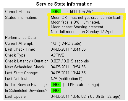

Yes, that document is a bit dated. :P Multi-line output is possible in the 3.x series of Nagios, but not 2.x or earlier. Using a Unix newline ("\n") is the correct way of doing this. As an example, I used the following code in a Python check plugin:
print "Moon OK - has not yet crashed into Earth.\n" + illumination_message + "\n" + phase_message + "\n" + next_full_message
which produced this output:
Note however that this will only display on the detail page for the particular service. The multiple-service tables such as the host status detail listing will still only display the first line.

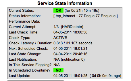

Here are the last few lines of the perl script that take care for formatting the data...
my $message = qw{};
foreach my $channel_name ( keys %channel){
$message = $message . "[ $channel_name :";
foreach my $key( keys %{$channel{$channel_name}}){
if( $key eq 'D' ) { $action_code = 'Deque'; }
elsif( $key eq 'E' ) { $action_code = 'Enqueue'; }
else{ next; }
$message = $message . " $channel{$channel_name}->{$key} $action_code";
$message = $message . " ]\n";
print "$message";
exit(0);
Here is what the output looks like on the host...
# ./collect_mta_log
[ tcp_intranet : 72 Deque 72 Enqueue ]
[ ims-ms : 102 Deque 102 Enqueue ]
[ reprocess : 0 Deque 0 Enqueue ]
[ tcp_pimp : 72 Deque 72 Enqueue ]
[ tcp_local : 4 Deque 3 Enqueue ]
[ process : 145 Deque 145 Enqueue ]
After Nagios it's taken in through NRPE only the first line is visible.
Screen shot 2011-04-05 at 11.01.41 AM.png (38.04 KiB) Viewed 6608 times

First, could you confirm what version of NRPE you're using and what OS these are on?
Second, could you humour me by trying this ultra-simplified plugin just to rule out any plugin-specific issues?
#!/usr/bin/env python
import sys
print "Checking multi-line output...\nIf you see this line it succeeded.\nCongrats!"
sys.exit(0)
