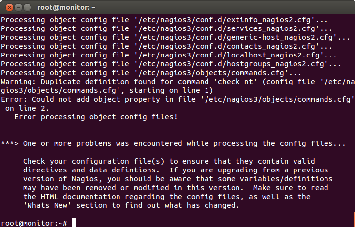

Hi Guys,

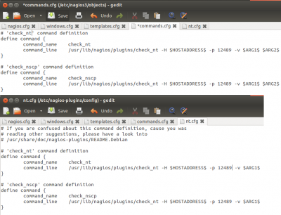

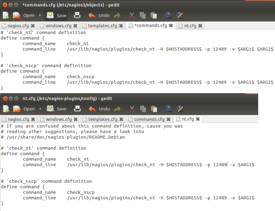

I’m trying to follow this guide (http://awaseroot.wordpress.com/2012/11/ ... th-nagios/) to monitor remote Windows machines but I’m testing it first on a local Windows box. However, I’m stuck with this error now (see attached) while running a check on my nagios.cfg, any ideas? I have also attached my commands.cfg and nt.cfg files so you guys could check on them. Let me know if you need further details from me.
Thank You,
Arnel

Post by sreinhardt »
Based on your definitions, you have dupicates in command.cfg and nt.cfg. I would suggest removing the commands from commands.cfg if you would like to separate them out, and leave them in nt.cfg. Alternatively, if you want all your commands in one place, remove nt.cfg from being imported via the main nagios.cfg. Once one is done, try verifying\staring nagios again.
