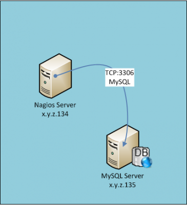

Hi!
I've been using Nagios and NDOUtils for quite some time.
Recently we've decided to use the latest Ubuntu Server LTS (12.0.4 64bits) and to separate the Nagios core server from the NDOUtils Database server.
Both Servers are Ubuntu 12.0.4 Server 64bit.
We are using Nagios 3.5.0 and NDOUtils 1.4b9.
I can use the configured account to access the database from the Nagios' server CLI.
When I restart nagios (having ndo2db already started) and I do a 'tail -f /usr/local/nagios/var/nagios.log' I get:
[1385747245] Nagios 3.5.0 starting... (PID=28945)
[1385747245] Local time is Fri Nov 29 17:47:25 UTC 2013
[1385747245] LOG VERSION: 2.0
[1385747245] ndomod: NDOMOD 1.4b9 (10-27-2009) Copyright (c) 2009 Nagios Core Development Team and Community Contributors
[1385747245] ndomod: Successfully connected to data sink.  61 queued items to flush.
[1385747245] ndomod: Successfully flushed 61 queued items to data sink.
[1385747245] Event broker module '/usr/local/nagios/bin/ndomod.o' initialized successfully.
[1385747245] Finished daemonizing... (New PID=28947)
[1385747246] ndomod: Error writing to data sink!  Some output may get lost...
[1385747246] ndomod: Please check remote ndo2db log, database connection or SSL Parameters
[1385747262] ndomod: Successfully reconnected to data sink!  0 items lost, 96 queued items to flush.
[1385747262] ndomod: Successfully flushed 96 queued items to data sink.
[1385747262] ndomod: Error writing to data sink!  Some output may get lost...
[1385747262] ndomod: Please check remote ndo2db log, database connection or SSL Parameters
[1385747278] ndomod: Successfully reconnected to data sink!  0 items lost, 88 queued items to flush.
[1385747278] ndomod: Successfully flushed 88 queued items to data sink.
[1385747278] ndomod: Error writing to data sink!  Some output may get lost...
[1385747278] ndomod: Please check remote ndo2db log, database connection or SSL Parameters
In nagios.cfg I have
event_broker_options=-1
broker_module=/usr/local/nagios/bin/ndomod.o config_file=/usr/local/nagios/etc/ndomod.cfg
I beleive it has something to do either with my ndomod.cfg or with my ndo2db.cfg and also with the fact that the database is not local
