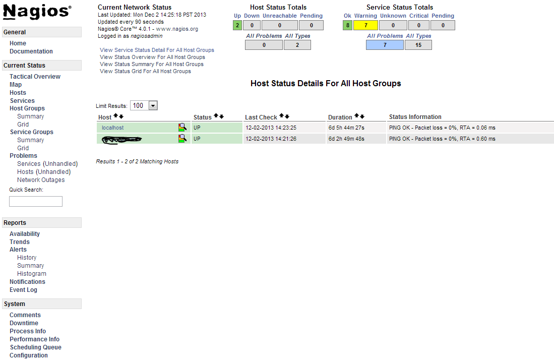

Re: Remove Windows Host
Can you post a web interface screenshot please?
costanza2k1
Posts: 197
Joined: Fri Aug 09, 2013 12:19 pm
Post by costanza2k1 »
Web shows old server still...
I got it to work...did a complete shut down on nagios instead of a reload and it came up...this can be closed. appreciate your patience with me.
Ahh yes, reload and restart are somewhat different. Restart is what you want in this case. Gonna lock this up, glad you figured it out.
