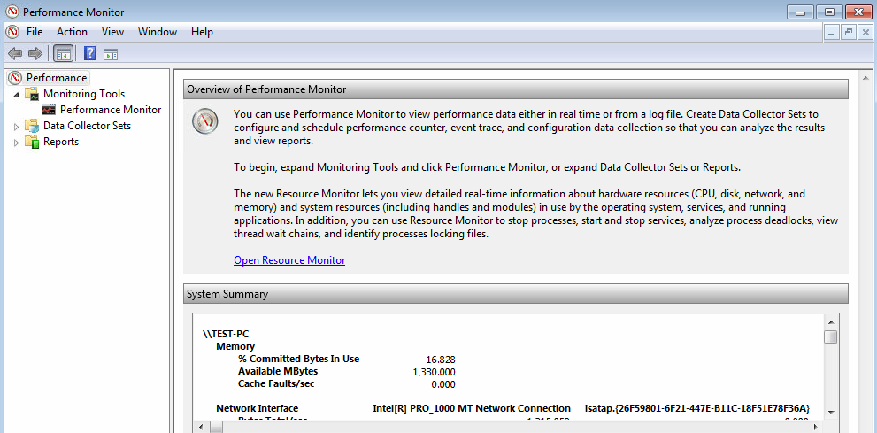

You can use windows performance counters found using "perfmon" to check the counter values of your NIC, please see:
https://www.nsclient.org/nscp/wiki/Chec ... eckCounter

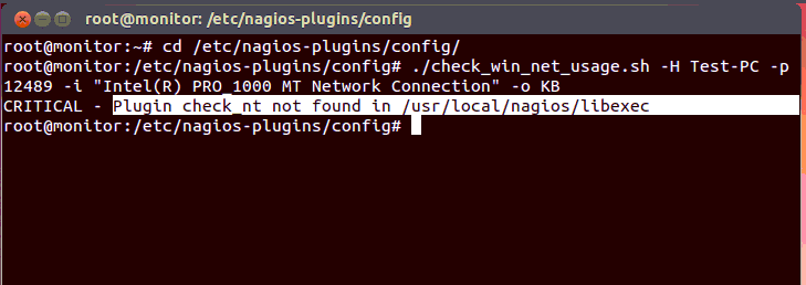

Thanks slansing! Looks like I could use this plugin too to monitor the bandwidth of the Windows host. Im trying to configure it now but upon trying to execute the command on the terminal, I received this error. Nagios plugins should be located on /etc/nagios-plugins/config/ directory correct? Prior to the error, should I create /usr/local/nagios/libexec? I dont even see this directory exists. Also, I cant find check_nt on /etc/nagios-plugins/config/ directory. Any suggestion how can I get that as well or create one if possible?

sreinhardt
-fno-stack-protector
Posts: 4366
Re: How to monitor the bandwidth usage of a Windows host?
Post by sreinhardt »
Offhand, I don't recall where they would be with ubuntu packages, source installs per our documentation would still have you place them in /usr/local/nagios/libexec. I would suggest looking at your commands.cfg and seeing what directory they are in. As for check_nt, it should have been created with the default nagios-plugins package\source build. You might also try a "find / -name check_nt" to see where it is. You will likely have to modify the script to point at your proper check_nt location.

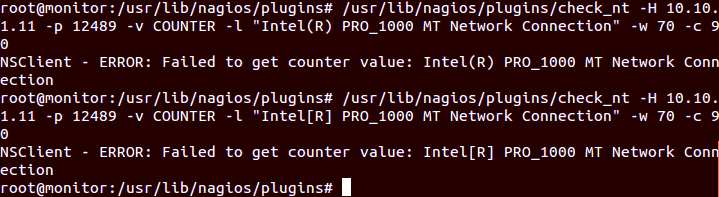

Thanks sreinhardt! I modified the script to my check_nt's location which is under /usr/lib/nagios/plugins. However, Im getting a different error now (see attached). Could it be that the client is missing the check_nt plugin? But it was included in the NSClient++ as far as I know. Any idea?

Posts: 7698
Post by slansing »
Can you send us a copy of the script you are using after the modifications were made? It looks like it may be having issues still, have you tried using just check_nt from the nagios server?

Noctis0791
Posts: 58
Joined: Wed Oct 09, 2013 3:41 pm
Post by Noctis0791 »
Thanks slansing. I got this result from that command.

Posts: 7698
Post by slansing »
I left out a couple key elements, try this one:
/usr/lib/nagios/plugins/check_nt -H addr.of.host -p 12489 -v COUNTER -l "\Network Interface(Intel[R] PRO_1000 MT Network Connection)\Bytes Total/sec" -w 7000 -c 9000
