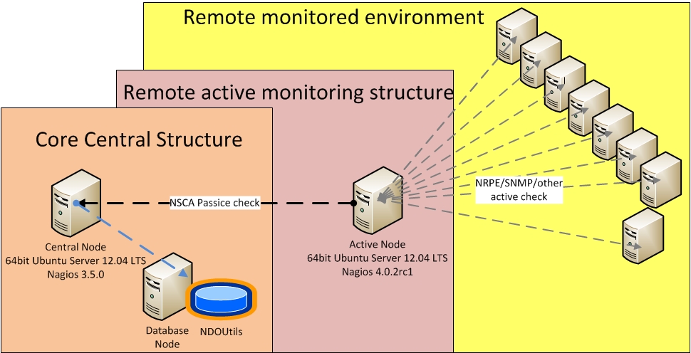

In an environment depicted in the attached picture, my Central Nagios' host receives the nsca submited servicechecks:
