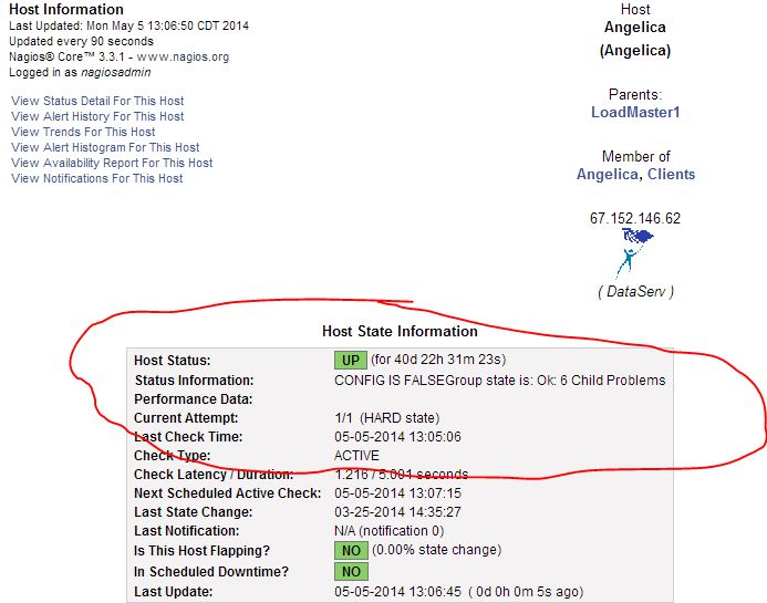

I get errors on numerous hosts after putting them in maintenance mode for several hours , any ideas how to fix? everything looks ok and services are fine but down time reporting is messed up now.

By maintenance mode, do you mean you put them in downtime? Is that status information from another check of some sort, like check_cluster? Please provide more details, or possibly a screenshot of what has been done to this system, what is happening presently, and what you feel it should be doing.

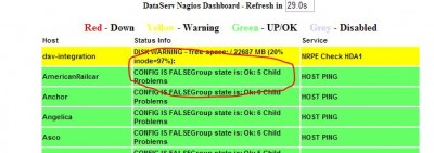

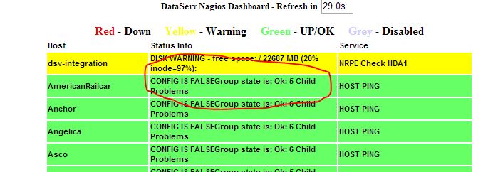

sorry yes, I put in scheduled downtime for a set period of time
it seemed to come out of scheduled downtime ok but when I look at a hosts status I see the error
see attached screenshot from Nagios dashboard and Nagios core

sheetzdw wrote:status Information: CONFIG IS FALSEGroup state is: Ok: 6 Child Problems
This looks like BPI output. Can you post the configuration and check command for of these problematic hosts?
