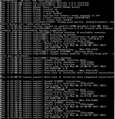

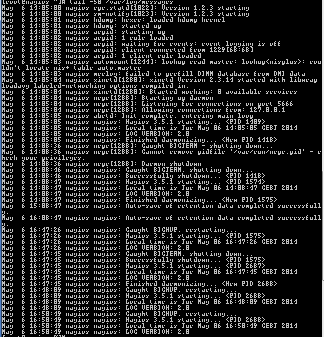

What is the current output of:
service nagios status
service ndo2db status
tail -50 /var/log/messages

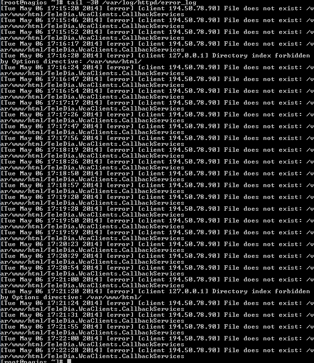

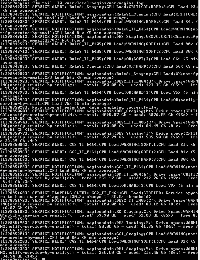

You said that the web interface is accessible, but what happens when you do try to use it? Do you get strange error messages? Can you not actually click links or buttons? Can you scroll through a page which has a scroll bar? Does the nagios log say anything at all? From around that time?:
tail -30 /usr/local/nagios/var/nagios.log
tail -30 /var/log/httpd/error_log

yes web interface is accessebile with all its functionalities but the last check of the services i see there is of 30-04-2014 12:00 , and same is the case if i go to event log via web interface i see log till 30-04-2014 12:00 . trying to commit to force the new schedulling time it takes a lot of time and in the end tells me gateway timout error. looking inside /usr/local/nagios/var/archives i see files till 30/04/2014.
[img]
[/img]
[img]
[/img]
[img]
[/img]
i am sorry i was unable to copy it so i upload some screen shots.

In your last image, you are showing a nagios version of 3.5.1, could you show what you did to install 4.0.6 and where it is showing you that it is that version? /var/log/messages, doesn't seem to show anything in particular pertaining to nagios, unless you have vastly changed the directory names. I would agree though, that your nagios log does not show any activity since 4/30 for one reason or another.

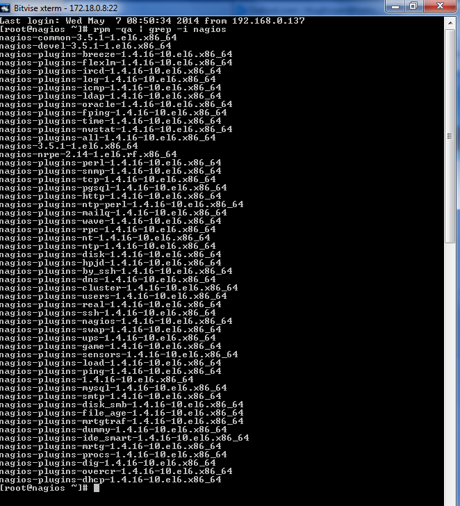

When you installed nagios previously, or the past tech did, was this done via source install or rpm? If you aren't sure, the easiest way to tell is:
rpm -qa | grep -i nagios

i tried this command and i the results, i am sorry that everytime i attach a screen shot , just because i am unable to copy and paste from terminal.
[img]
[/img]
