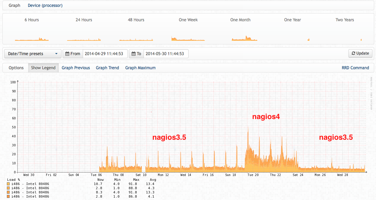

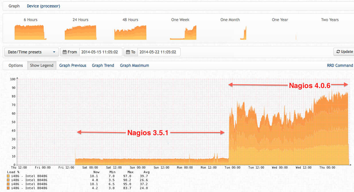

I have the same issue as in this post with two Nagios installation on OS X 10.9 with Nagios 4.0.6 & Nagios Plugins 2.0. The load nagios 4 is producing on these machines is really amazing ;-). I just reverted today to 3.5.1. To get an impression have a look at the attached PNG

thanks for your reply and sorry that it had taken some time for my response. I did the testing an a different machine as I didn't want to mess around with my main monitoring system. The "testing" machine (17hosts 86 services) has far less checks but the effect is still very recognizable but clearly not as dramatic as it was on the production system (73 hosts 243services). The testing system is a Mac mini 6,1 with a Core i5 Ivy Bridge 2,5Ghz with 16GB RAM running Mac OS X 10.9.3 with Server.app. As the free -m command does not exits on this platform I posted a vm_stat as a substitute.

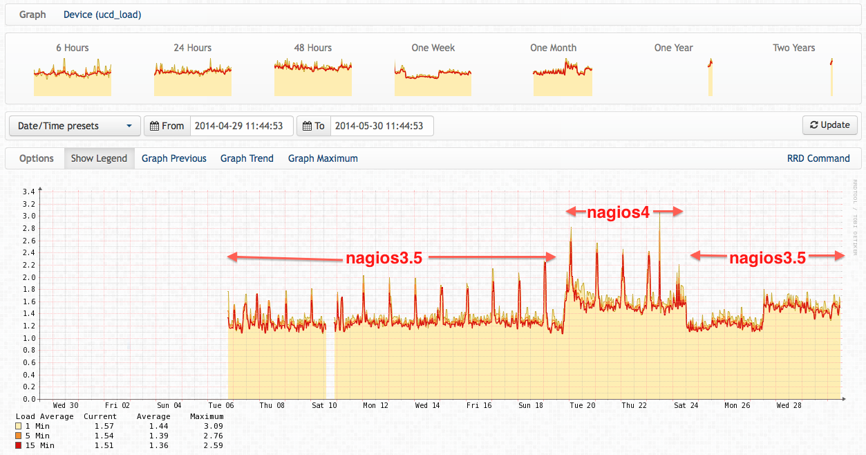

I noticed that your graph is saying load percentage. Is that a load check or cpu percentage, because they are quite different. I do believe we have a possible mixture of a bug and systems seeing load increases due to the number of worker processes now. As for the graph, I just wanted to confirm exactly what we were looking at, as it is rather odd to label load as a percentage.

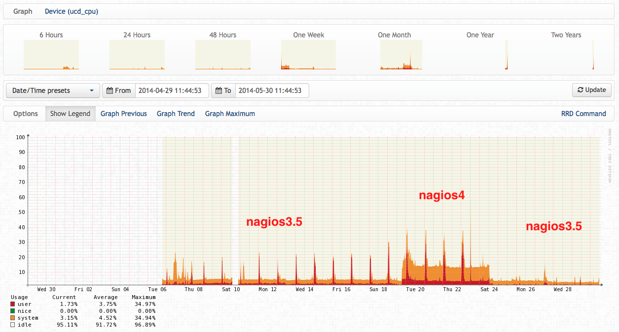

Hi
here are the other graphs I can provide. hope this helps.
