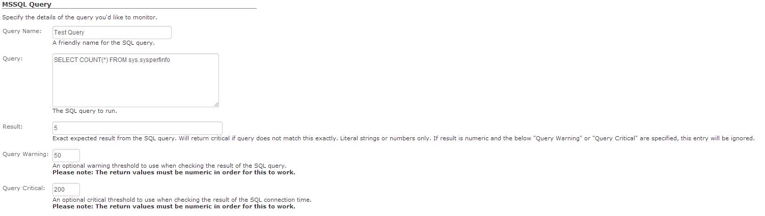

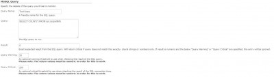

Re: MSSQL check that will return query value as perf data
So, maybe the Wizard changed with 2014 and I'm looking at something new here?
The query I need to run tells me how many records were written to given table in the last X minutes.
I want it to return a low value and warn if >15, critical >30. But I usually expect around 1-5.
The "expected result" field here in the wizard appears to want a higher expected value or it ignores it?
-Andrew
-Andrew
Is it that the plugin is ignoring it, or the wizard is? Once you've gone through the wizard could you provide the command within the service definition that it is giving? I just want to be sure we are getting the same things.

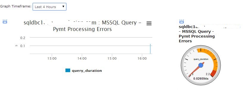

I've got the query running successfully with the MS SQL Query wizard, but as you can see, it's only charting the response time...

Can you go to the Advanced tab of the service view and see what perfdata is being returned? If you want to graph the actual SQL result it will need to be in the perfdata.
Performance Data: query_duration=0.053464s;1;2;0;Andrew J. - Do you even grok?
