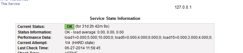

Re: check_procs wrong response
My mistake. Same process though. This is the info I need:

vvz
Posts: 187
Joined: Wed Oct 30, 2013 5:15 pm
Post by vvz »
it is on web-interface :
Zombies processes
Notifications for this service have been disabled
WARNING 06-27-2014 13:03:46 0d 0h 5m 5s 2/5 PROCS WARNING: 26 processes with STATE = Z
[img]
Service State Information
Current Status: OK (for 0d 0h 0m 20s)
Status Information: PROCS OK: 10 processes with STATE = Z
Performance Data:
Current Attempt: 1/5 (HARD state)
Last Check Time: 06-27-2014 13:06:46
Check Type: ACTIVE

I've just remarked that PERFORMANCE DATA line is empty for all services for all hosts.
Something is wrong with that?
