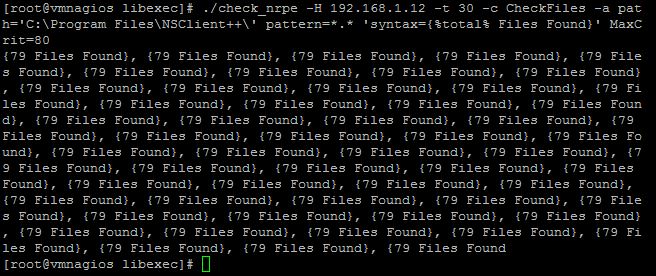

I did the same thing but i am getting error, saying " missing arguments"
But when i am trying from nagios server through terminal, i am getting the following output [screen shot attached and configuration files attached]:
Command :
./check_nrpe -H 192.168.1.12 -t 30 -c CheckFiles -a path='C:\Program Files\NSClient++\' pattern=*.* 'syntax={%total% Files Found}' MaxCrit=80
Output :
"{79 Files Found}, {79 Files Found}, {79 Files Found}, {79 Files Found}, {79 Files Found}, {79 Files Found}, {79 Files Found}, {79 Files Found}, {79 Files Found}, {79 Files Found}, {79 Files Found}, {79 Files Found}, {79 Files Found}, {79 Files Found}, {79 Files Found}, {79 Files Found}, {79 Files Found}, {79 Files Found}, {79 Files Found}, {79 Files Found}, {79 Files Found}, {79 Files Found}, {79 Files Found}, {79 Files Found}, {79 Files Found}, {79 Files Found}, {79 Files Found}, {79 Files Found}, {79 Files Found}, {79 Files Found}, {79 Files Found}, "
Any solution to this??
Why i am not able to get the value in nagios?? in wepage its showing "Missing argument"
Command :
Output :

Use master-syntax instead of syntax
Also, use double back slashes for the folder path
Command:
./check_nrpe -H 192.168.207.1 -t 30 -c CheckFiles -a path='C:\\Program Files\\NSClient++\\' pattern=*.* 'master-syntax={%total% Files Found}' MaxCrit=80
Output:
{111 Files Found}|'count'=111;0;80As of May 25th, 2018, all communications with Nagios Enterprises and its employees are covered under our new Privacy Policy.
