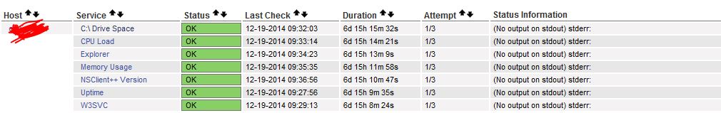

deepshikha20
- Posts: 33
- Joined: Fri Oct 31, 2014 1:19 am
Re: (No output on stdout) stderr:
Please find the attached screenshot which gives you a clear picture about the error i am facing.
Thanks.
Regards,
Deepshikha
Thanks.
Regards,
Deepshikha
sreinhardt
- -fno-stack-protector
- Posts: 4366
Can you post your nagios.cfg and resources.cfg files please? It looks like you are not appending a path to the commands, and so nagios may not know where to look for them.
