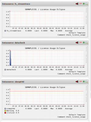

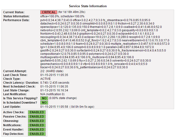

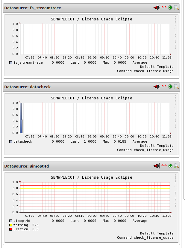

Hi, we have written a plugin which runs successfully and returns data for the number of licenses being used on a license server. We are running pnp4nagios to graph the output and while some of the graphs are correct others don't display the warn/crit lines. We are running nagios core 3.4.1 and pnp4nagios v 0.6.19. I've attached two screen shots showing the plugin output
and some graphs produced
Can you help?

Hi, sorry I realized the graphs are auto scaling the vertical axis so the warning and critical lines wont be displayed as the perf data is no where near warning or critical! I don't know much php do you know how I stop the graph from auto scaling? They are using the default template.
Many thanks
Steve.
