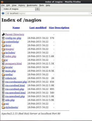

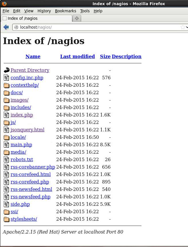

If I change the Options line under the directory entry "/usr/local/nagios/share" to:
Options All
and run "service httpd restart", then I can access the website at http://localhost/nagios. However, the "Service Detail" navbar link mentioned at http://nagios.sourceforge.net/docs/nagi ... edora.html is missing. I just see a listing of files as seen in the attached screen shot. What am I doing wrong that I don't see the "Service Detail" navbar? What value should I have for the /nagios options line?

Then I get the above screenshot which shows the files under /nagios with no "Service Detail" navbar.
What am I still doing wrong? Could there be something wrong in the Apache config file /etc/httpd/conf/httpd.conf? Could I have an option in there that is not set correctly? I have attached the apache main config file (/etc/httpd/conf/httpd.conf) and the Nagios Apache config file (/etc/httpd/conf.d/nagios.conf).
