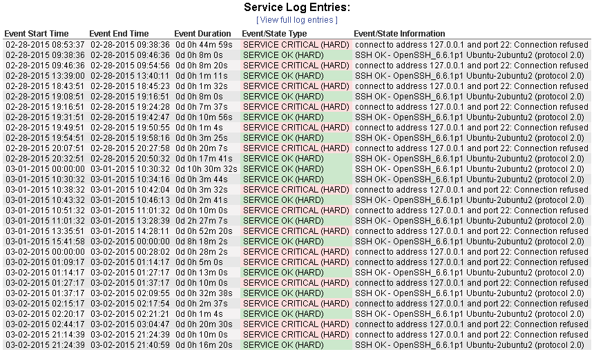

There are a few more commands on the SSH service as that's the one I've been working on to get it to work, so then I could apply to the others, but to no avail.

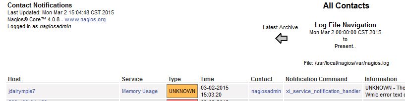

If you drill into the core notifications can you see where that notifications were attempted at all? Just click Notifications on the left-hand pane.
See my attached example of what you should expect to see.

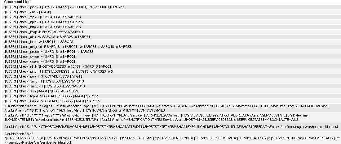

Post by NagiosRoss »
I've attached what my notifications look like. It even says notify by email... What the?!
Also included the 'notify by email' command it executed.

Re: Notifications
Post by jdalrymple »
I think those are ones that you've manually kicked off using the Send custom service notification button. Is that possible?
Otherwise you shouldn't see (CUSTOM) like you do.
You're not seeing any that don't have (CUSTOM) in front of them?

Can you do the following:
Find the SSH service
Click the link "View Availability Report For This Service" (top left)
There should be a list of SOFT and HARD states
You may need to change the report period to 'This Week' to show older history (top right)
Show us a screenshot of of the Service Log Entries.
jdalrymple wrote:I think those are ones that you've manually kicked off using the Send custom service notification button. Is that possible?
Yes that's right, those are the custom ones. However I didn't receive the second one to say it was up, even though that is labelled as CUSTOM.
Box293 wrote:Can you do the following:
