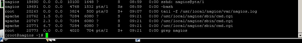

ps aux | grep nagios reveals that i have the exact same number of submits of the following running.
Apache /usr/local/nagios/sbin/cmd.cgi
At this point the Nagios Service is no longer running.
Nagios-Not-Running
Nagios-Not-Running

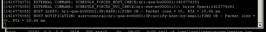

In the tail -f /usr/local/nagios/var/nagios.log - I can see the first request be transmitted, but all remaining request do not occur.
If i restart the Nagios and Httpd services, I can again submit (less than 3) host commands, then the system stops accepting.
