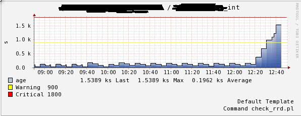

rrd-chk.jpg:
this check checks how often updates certain rrd files.

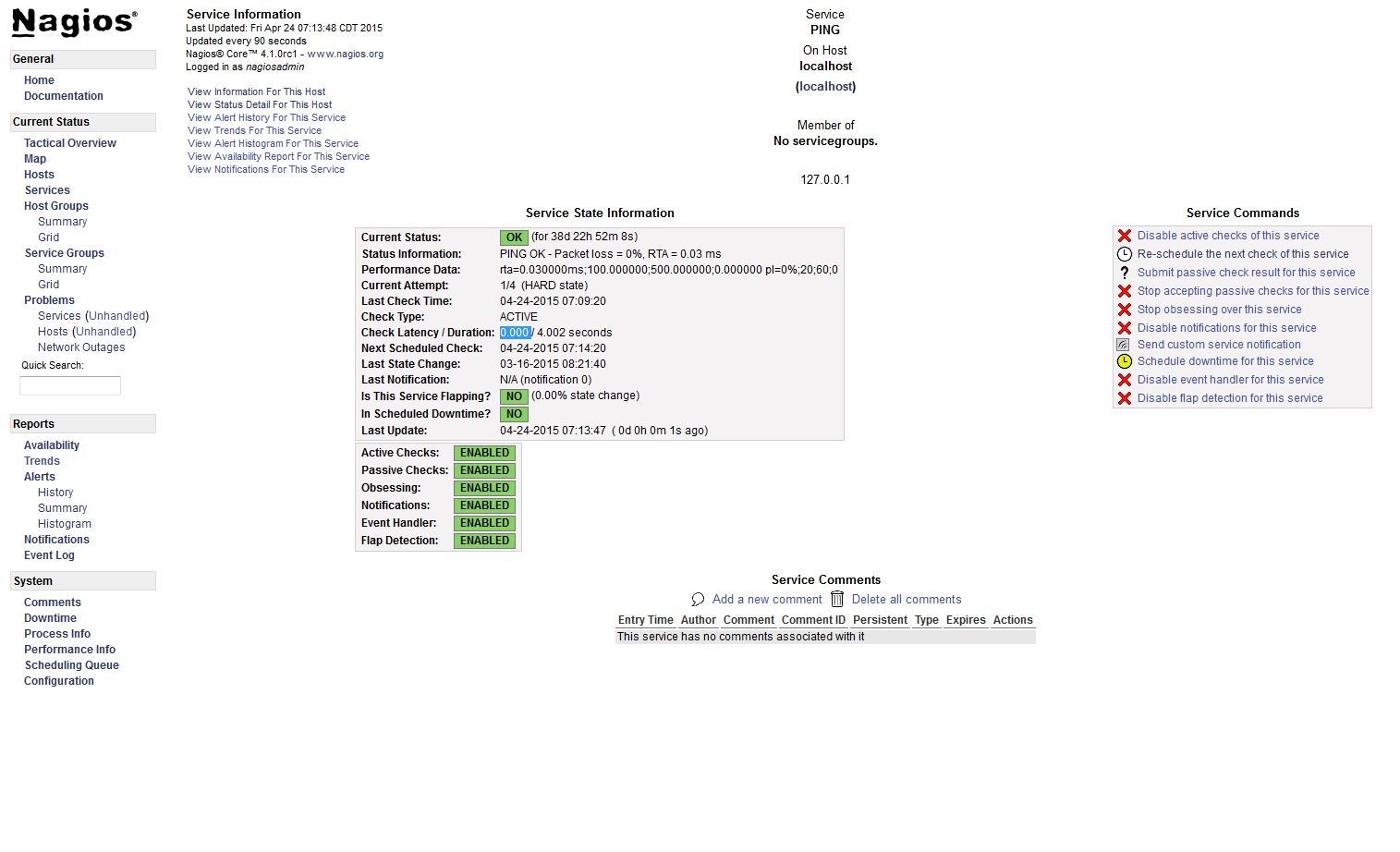

If you view the extended details of one of your affected services, what do you see? Please post a screenshot similar to the following:
I am interested in the check latency/duration - perhaps the check is taking a long time to execute? It's also possible that the latency is high.
Is there any excessive load on the server - are the resources being starved?
top
free -m

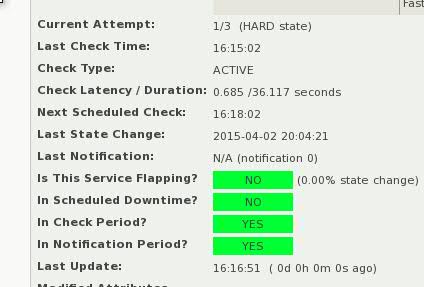

same service:
Check Latency / Duration: 	1.823 /34.001 seconds

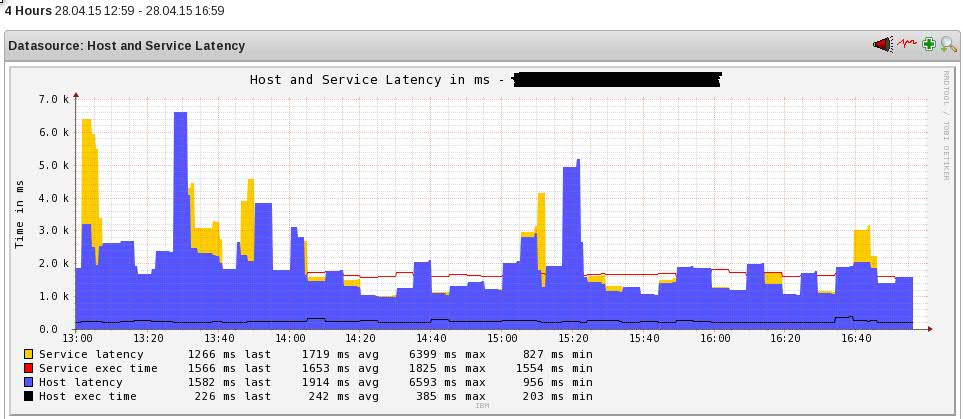

I attach a graph with the visualizes host/service latency based on nagiostats.
