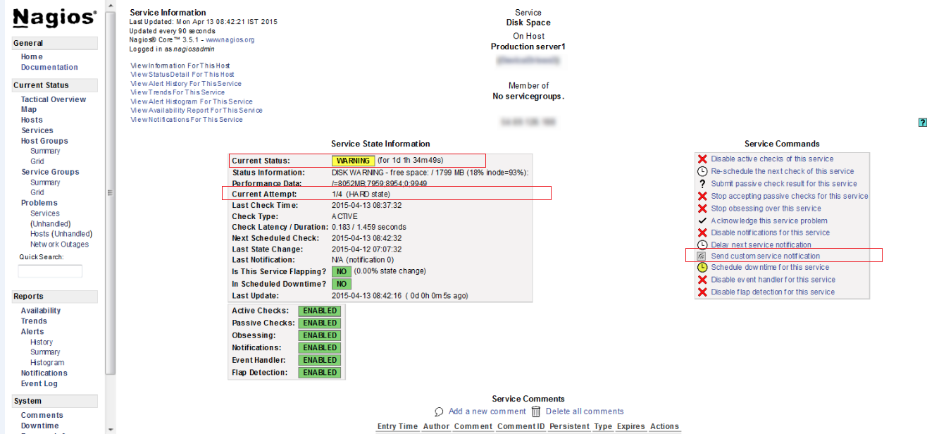

I have started noticing that I am not getting any warning mail from my nagios server. If I send out using the 'Send custom service notification', I can see the mail. So I think there is some configuration issue that is causing this. Can someone please check my configurations below and advise if any changes are required. Also, How can I check when this warning status started logging in ? I have checked /var/log/nagios3/nagios.log but couldn't find any entry related with this.

Service status showing as warning

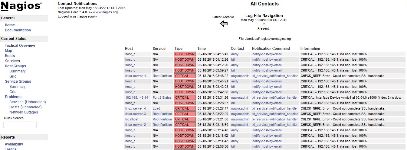

I don't think we ever verified through the GUI whether or not notifications were even "firing" have we? You can just click "Notifications" under "Reports" in the menu pane. Attached is what mine looks like. Please share a screenshot of what yours looks like with us.

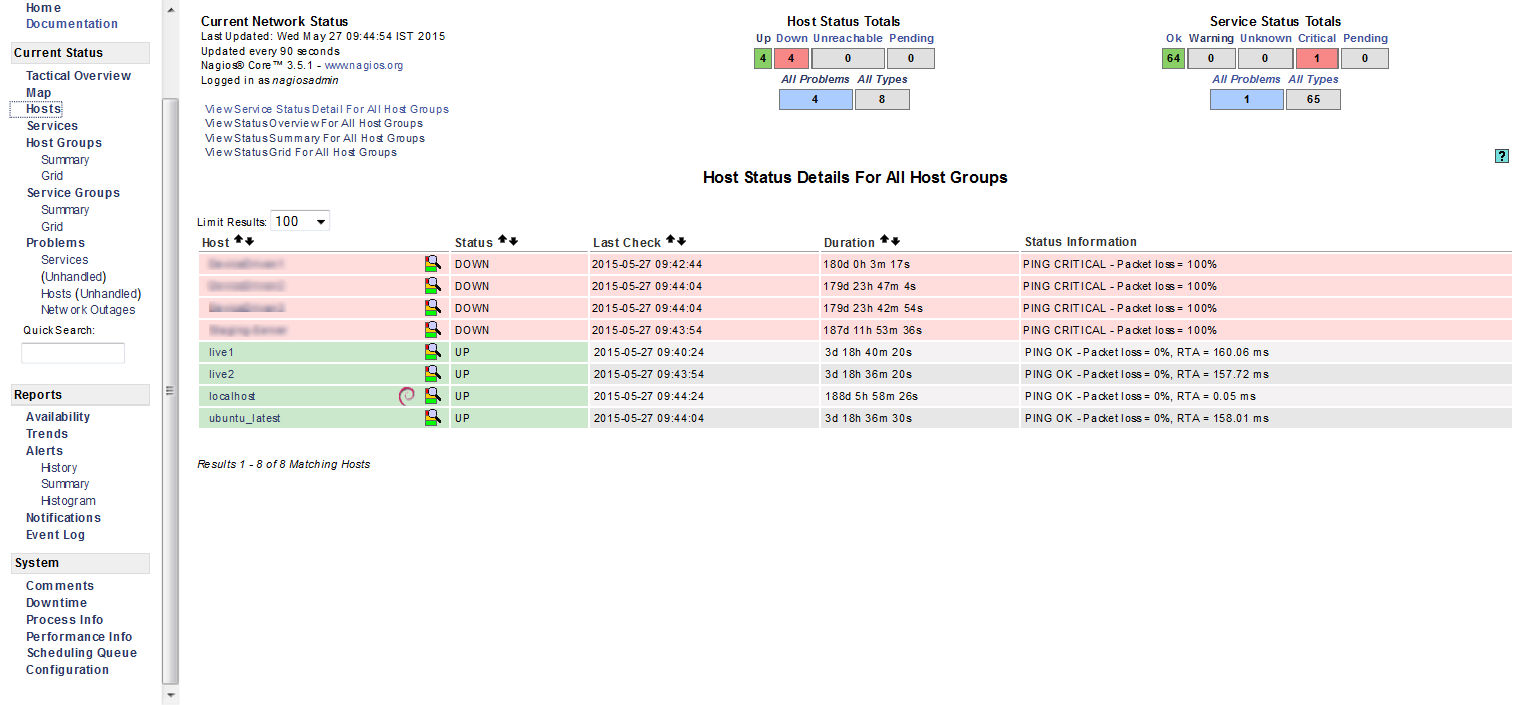

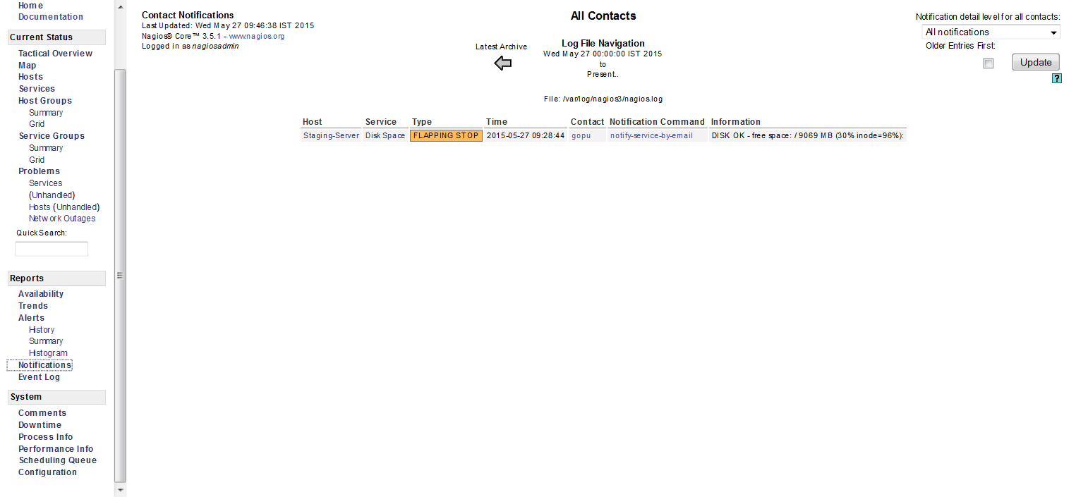

I think you are directing me in the correct way. I was able to reproduce the issue again (alerts not coming for certain services) and I can provide you the screenshots as well. In the services, you can see one host is having disk space critical and we haven't received any alert. The interesting thing is I cant see this service in the notifications list you asked me to send. I can see only flapping alert in the notification section for which I am getting the email correctly. So something there wrong with the service definition of this host ? You can see the actual service definitions and notification settings in my first reply to this post. In the host section, you can see the hosts are showing as down since there is no ping to them. Is it causing the services to stop sending the emails ? In that case also, I am getting flapping alerts correctly! Please let me know if you need any information, as I am mad at this issue.

notifications only listing the flapping and no disk alert came here
services showing that disk usage is critical in one of the server
