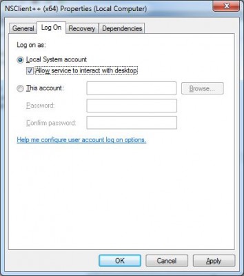

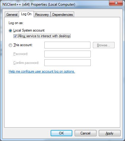

Although, oddly enough, that still doesn't work. It launches the process under the correct username, but the user can't see the program. And if you uncheck "Show processes from all users" it hides it, which indicates its not running in the same login session.
jdalrymple
Skynet Drone
Posts: 2620
Re: NRPE - Launch BAT as current user
Post by jdalrymple »
Check this checkbox
