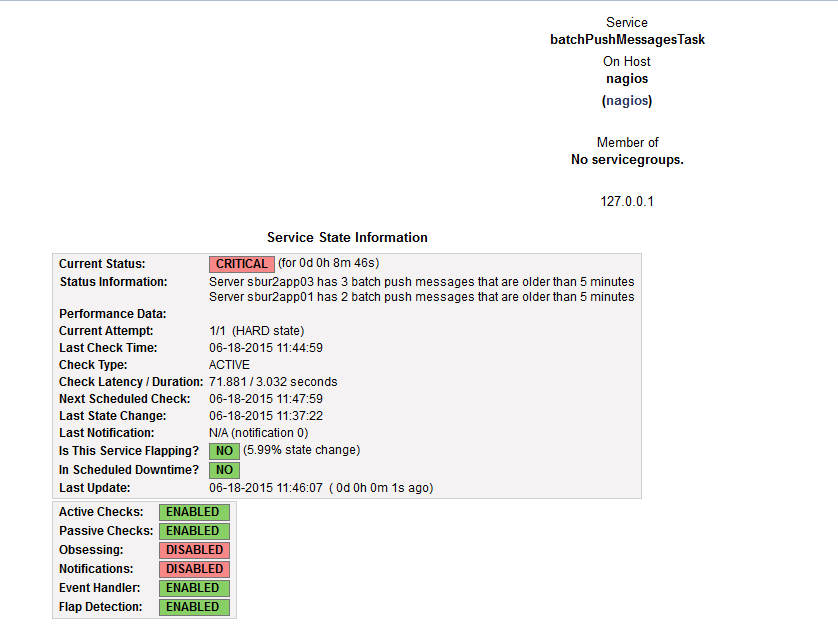

lmiltchev wrote:Can you show us an example of your multiline message and what you actually receive as a notification? Also, show us the notification command that you are using.
Attached is a screenshot from the nagios ui, where you can see the multiline status information
Here is the email body, where the same status info is not multiline
***** Nagios *****
Notification Type: PROBLEM
Comment:
Service: batchPushMessagesTask
Host: nagios
Address: 127.0.0.1
State: CRITICAL
Date/Time: Thu Jun 18 11:49:41 PDT 2015
Additional Info:
Server sbur2app03 has 3 batch push messages that are older than 5 minutes Server sbur2app01 has 2 batch push messages that are older than 5 minutes
This is my command definition
command_line /usr/bin/printf "%b" "***** Nagios *****\n\nNotification Type: $NOTIFICATIONTYPE$\nComment: $SERVICEACKCOMMENT$\n\nService: $SERVICEDESC$\nHost: $HOSTALIAS$\nAddress: $HOSTADDRESS$\nState: $SERVICESTATE$\n\nDate/Time: $LONGDATETIME$\n\nAdditional Info:\n\n$SERVICEOUTPUT$\n$LONGSERVICEOUTPUT$" | /bin/mail -s "$HOSTALIAS$/$SERVICEDESC$ is $SERVICESTATE$ " $CONTACTEMAIL$

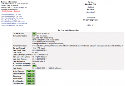

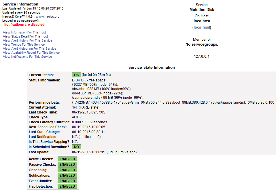

I was not able to recreate the issue. I tested the multiline in Nagios XI, but I am running Nagios Core 4.0.8 underneath. The $LONGSERVICEOUTPUT$ seems to work fine for me.
From the CLI:
./check_disk -w 20 -c 10 -A -n
DISK OK - free space:
 / 9227 MB (55% inode=91%);
 /dev/shm 938 MB (100% inode=99%);
 /boot 361 MB (80% inode=99%);
 /var/nagiosramdisk 99 MB (99% inode=99%);
| /=7423MB;17523;17533;0;17543 /dev/shm=0MB;918;928;0;938 /boot=89MB;456;466;0;476 /var/nagiosramdisk=0MB;80;90;0;100
In Nagios Core:
Notification command:
       command_name                  		notify-service-by-email
       command_line                  		/usr/bin/printf "%b" "***** Nagios Monitor XI Alert *****\n\nNotification Type: $NOTIFICATIONTYPE$\n\nService: $SERVICEDESC$\nHost: $HOSTALIAS$\nAddress: $HOSTADDRESS$\nState: $SERVICESTATE$\n\nDate/Time: $LONGDATETIME$\n\nAdditional Info:\n\n$SERVICEOUTPUT$\n$LONGSERVICEOUTPUT$" | /bin/mail -s "** $NOTIFICATIONTYPE$ Service Alert: $HOSTALIAS$/$SERVICEDESC$ is $SERVICESTATE$ **" $CONTACTEMAIL$
Actual notification received:
Notification Type: CUSTOM
Service: Multiline Disk
Host: localhost
Address: 127.0.0.1
State: OK
Date/Time: Fri Jun 19 09:45:17 CDT 2015
Additional Info:
 / 8829 MB (53% inode=91%);
