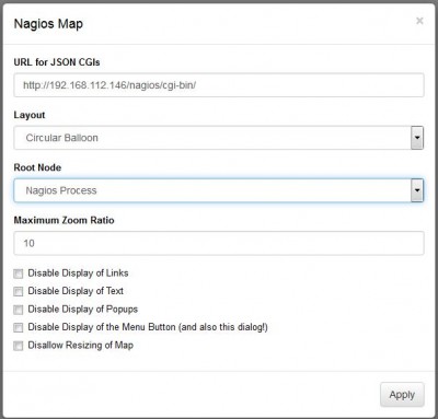

In Nagios Core 4.1.0rc1, you can customize the map screen.
Click on the Maps link and then click the top right corner where the 3 bars are.
This screen will allow you to customize the map screen. Then set the Root Node to the system you want as the starting point.
Is this what you are looking for?

Thanks for that, i've seen that but is there anyway to make this default encase we have to restart Nagios?
Re: Nagios 4 MAP Changes
That could possibly be added to Core, but I'll be honest with you, that part of the interface is written in AngularJS and it's a complicated beast of a framework. I have an idea of what would need to be changed, but not a clue what possible other bugs that could introduce.
Your best bet getting this into the project would be to open an issue for it in GitHub:
https://github.com/NagiosEnterprises/nagioscore
Open an issue with a title like "[Enhancement] Allow setting map defaults" and link to this thread, explaining the request briefly as well. This will get it on the devs' radars and they can start looking into ways to implement it.
