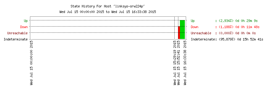

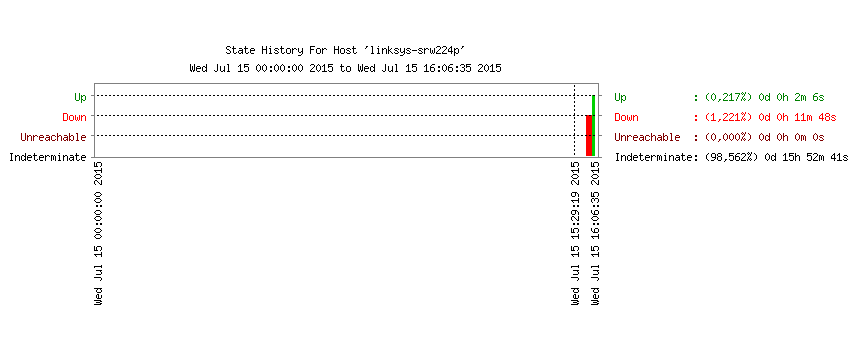

Yeah, i think it doesnt work, i put a test: i shut down the switch for some minutes and i did the "Trends" report and work
But i do another test,i shutted down nagios server and the switch monitored, so, i wanted that nagios report the time that the switch was down, but it doesnt did. its like was up all time, i think if nagios is down it cant report the informations of the time states :c
second test
second test
first test
first test
