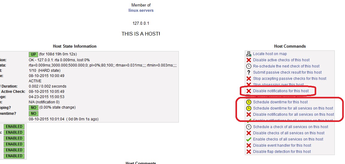

Have you tried scheduling downtime for the host or have you clicked the disable notifications on the host? Are you getting any errors when doing that?

Also, the generally accepted way of dealing with this is to just disable notifications in the CGI or put the server into a downtime. Why not use one of those options (suggested above by ssax)?

Were you receiving Host notifications or Service Notifications, or both?
When you schedule downtime, you will have to schedule downtime for host and services separately.

Good to know. Thanks so much for the info.tgriep wrote:Were you receiving Host notifications or Service Notifications, or both?
