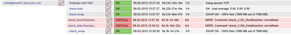

NRPE: Command 'check_LV01_RootDirectory' not defined
The Picture 1 show the command not defined.

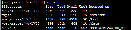

The Picture 2 show the nagios client disk information.

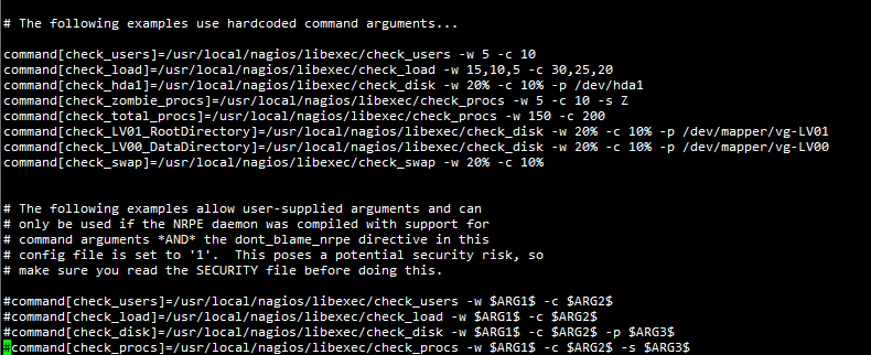

In picture 3 I add two lines in the nrpe.cfg , it's :
command[check_LV01_RootDirectory]=/usr/local/nagios/libexec/check_disk -w 20% -c 10% -p /dev/mapper/vg-LV01
command[check_LV00_DataDirectory]=/usr/local/nagios/libexec/check_disk -w 20% -c 10% -p /dev/mapper/vg-LV00

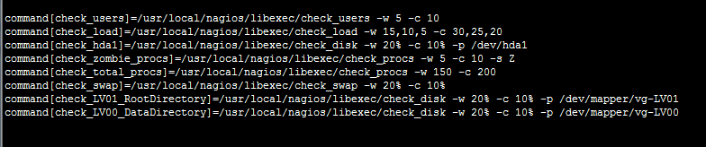

The Picture 4 show the nrpe.cfg in nagios client.
In picture 4 I add two lines in the nrpe.cfg , it's :

When I finish complete this configuration , The Picture 1 show the command not defined.
So I want to know where configuration is wrong ?
The Picture 3 show the nrpe.cfg in nagios server.

According to the method you tell me .
The picture 11 show the nagios client config of the nrpe.cfg
The picture 12 show the nagios server config of the nrpe.cfg
