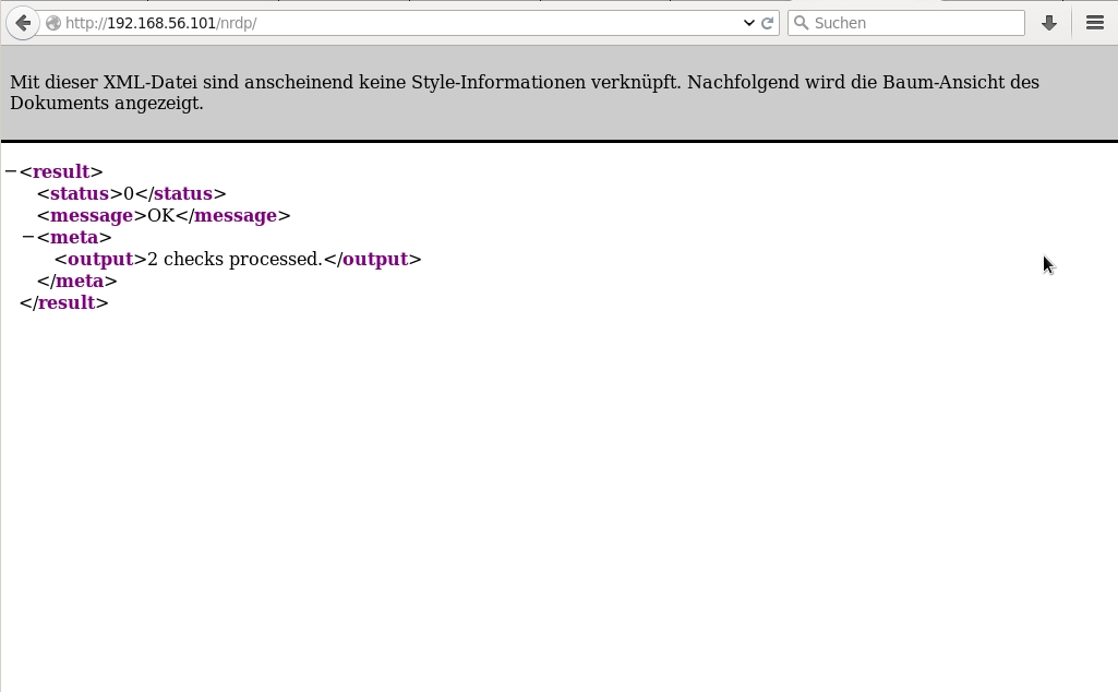

RandomGuy86 wrote:when I open its server API I get the following error message:
http://<ipaddress>/nrdp
Mit dieser XML-Datei sind anscheinend keine Style-Informationen verknüpft. Nachfolgend wird die Baum-Ansicht des Dokuments angezeigt
Translated to Englisch:
This XML-File seems to not be linked to style information. Below this message the tree view will be displayed
Interesting. Do you have any entries in your Apache error log when this happens? Can you post a screenshot of the page?
RandomGuy86
Posts: 21
Joined: Tue Sep 08, 2015 10:12 am
Re: Some questions about NCPA
Post by RandomGuy86 »
Apache /var/log/httpd/error_log (just the few latest entries):
[Tue Sep 08 19:21:30 2015] [error] [client 127.0.0.1] Directory index forbidden by Options directive: /var/www/html/
[Tue Sep 08 19:26:30 2015] [error] [client 127.0.0.1] Directory index forbidden by Options directive: /var/www/html/
[Tue Sep 08 19:31:15 2015] [error] [client 192.168.56.101] PHP Notice:  Use of undefined constant nagi_os_NRDP - assumed 'nagi_os_NRDP' in /usr/local/nrdp/server/config.inc.php on line 14, referer: http://192.168.56.101/nrdp/
[Tue Sep 08 19:31:15 2015] [error] [client 192.168.56.101] PHP Warning:  date(): It is not safe to rely on the system's timezone settings. You are *required* to use the date.timezone setting or the date_default_timezone_set() function. In case you used any of those methods and you are still getting this warning, you most likely misspelled the timezone identifier. We selected 'Europe/Berlin' for 'CEST/2.0/DST' instead in /usr/local/nrdp/server/plugins/nagioscorepassivecheck/nagioscorepassivecheck.inc.php on line 105, referer: http://192.168.56.101/nrdp/
[Tue Sep 08 19:31:30 2015] [error] [client 127.0.0.1] Directory index forbidden by Options directive: /var/www/html/
Yes, I guess there is something wrong here.
Screenshot:
Let's try clearing some of these error messages.
1. Set the correct timezone in the "/etc/php.ini" and restart apache
2. Run the following commands and show the output:
grep /etc/group
nmap localhost
iptables -nL
sestatus
3. Post the "nagios.conf" file.
I am sorry - my bad, I meat to ask you to run:
grep nag /etc/group
not
grep /etc/group
For troubleshooting purposes, disable selinux and stop iptables:
setenforce 0
service iptables stop
Also, I wanted to see the "nagios.conf", not the "nagios.cfg". It should be in: "/etc/httpd/conf.d/nagios.conf". Thanks!
