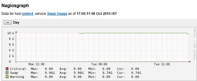

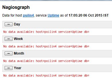

And i have attached the working and non-working parameter of the same host.
Working
Working
Not working
Not working

in the nagiosgraph.log its displaying as
hostname:host1
servicedesc:Oracle TNS Ping
output:OK - reply time 0 msec
perfdata:
Wed Oct 7 06:51:02 2015 insert.pl 16876 warn output/perfdata not recognized:
Do i need to set anything in the insert.pl script or the Oracle TNS Ping script ?
It able to collect the data and plot the graph for the scrips that got installed with the nagios plugins, it unable to fetch the data for the scrips that i have created manually...
My custom scripts are unable to display/fetch the performance data, is it the reason?
If so how to resolve that ?
jdalrymple
Skynet Drone
Posts: 2620
Re: Nagios Graph error
Post by jdalrymple »
Perfdata has to fit a specific format. That format is outlined in our plugin guidelines.
