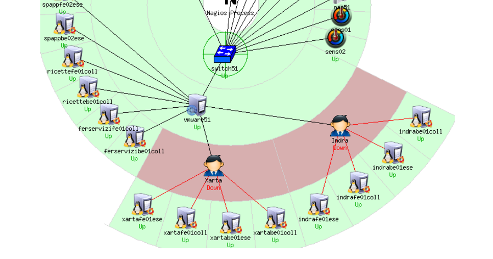

Hi guys,
I'm having the following problem with the monitoring nagios. As you can see from the picture, I have two hosts: Indra and Xarta under monitoring but in reality they are the hosts to be monitored and therefore the gaming me reports them in a state of "down" but are under a node level or levels Vmware51 intermediate. Therefore I wanted to ask if it is possible to eliminate the state of "down" from the hosts and Indra Xarta.
Thank you,
Andrea
Map Display monitoring nagios.

You can create a template that does not contain the line check_command check-host-alive:
Include this lines on templates.cfg:
	name				generic-dead-host
	use				generic-host
	check_period			24x7
	check_interval			5
	retry_interval			1
	max_check_attempts		10
	notification_period		24x7
	notification_interval		1440
	notification_options		d,r
	contact_groups			admins
	register			0
I know that some lines above are useless to this template, but Nagios will return errors if you remove them.
Host definition:
	use			generic-dead-host
	host_name		XXXXX
	alias			XXXX
	address			X.X.X.X
	hostgroups		xxxx
	parents			XXXX
	notes_url		http://X.X.X.X
	icon_image_alt		XXXX
	retain_status_information 	0
The hosts using the generic-dead-host template will be shown as PENDING and will never be checked.
For further details, read the article where I got this solution: http://sourceforge.net/p/nagios/mailman ... /17918052/
Regards

aruggeri
Posts: 8
Joined: Tue Jul 14, 2015 6:27 am
Re: Change "down" status
Post by aruggeri »
Good morning guys,
with the answers that you gave me.
I made the modifications described above, but the system is still not working.
I post as I defined my host:
# A host definition for the gateway of the default route
define host {
host_name Indra
use generic-host
parents vmware51
define hostextinfo {
host_name Indra
icon_image cook/img.png
statusmap image cook/img.png
While within files hostgroups nagios 2.cfg I did the following:

I see that you are still using the generic-host template for Indra
define host {
host_name Indra
use generic-host
parents vmware51
You need to use the template that does not contain the command check-host-alive.
Could you post the files templates.cfg and hosts files?

aruggeri
Posts: 8
Post by aruggeri »
Good morning guys,
as always, thank you the help that you are giving me.
Unfortunately they are just starting out with the Nagios system and of the time I still have difficulties in the administration of the total system.
Then I as a configuration file using the following:
/etc/nagios3/conf.d/indra.cfg
and its content is as follows:
define host {
host_name Indra
use generic-host
parents vmware51
host_name Indra
icon_image cook/clienti.png
statusmap_image cook/clienti.png
For "template.cfg" What do you mean?
Greetings,
Andrea

Post by eloyd »
Nagios comes pre-shipped with a configuration file called "template.cfg" in the same directory as all your other config files. He's asking for that.
Also, rather than not have a check_command and have hosts show pending, I recommend using the check_dummy command, which will simply return whatever state you give it without actually doing anything. In essence, your check_command becomes "check_dummy 0" if you always want the hosts to show as OK.

Unfortunately guys inside my directory:
/etc/nagios3/conf.d/ I not have the file called "template.cfg"
Below you will find the contents of that directory tree:
root@nagios51:~# ls /etc/nagios3/conf.d
backup51.cfg                 indrabe01coll.cfg      services_nagios2.cfg
contacts_nagios2.cfg         indrabe01ese.cfg       services_nagios2.cfg~
contacts_nagios2.cfg~        indra.cfg              services_nagios2.cfgu
demobe.cfg                   indrafe01coll.cfg      spappbe02ese.cfg
demofe.cfg                   indrafe01ese.cfg       spappfe02ese.cfg
dns51.cfg                    localhost_nagios2.cfg  switch51.cfg
extinfo_nagios2.cfg          log51.cfg              testbe.cfg
ferservizibe01coll.cfg       mgmt.cfg               testfe.cfg
ferservizife01coll.cfg       mon01.cfg              timeperiods_nagios2.cfg
fw02.cfg                     mon02.cfg              vmware51.cfg
fw03.cfg                     nagios52.cfg           vmware53.cfg
fw04.cfg                     nas41.cfg              xartabe01coll.cfg
gateway.cfg                  nas51.cfg              xartabe01ese.cfg
generic-host_nagios2.cfg     ricettebe01coll.cfg    xarta.cfg
generic-service_nagios2.cfg  ricettefe01coll.cfg    xartafe01coll.cfg
hostgroups_nagios2.cfg       sens01.cfg             xartafe01ese.cfg
hostgroups_nagios2.cfg~      sens02.cfg
I hope that the information that I am giving are sufficient to explain the type of problem encountered.
Greetings,
Andrea.
eloyd
Cool Title Here
Posts: 2190
Location: Rochester, NY
Post by eloyd »
It will likely be in the generic-host_nagios2.cfg file. You can type "grep generic-host *" to find out which file your generic-host template is in. That's likely the one that needs to be updated.
