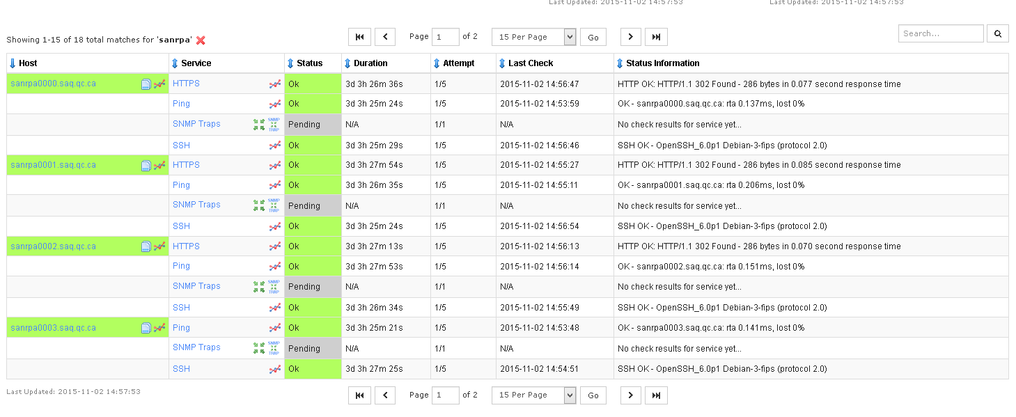

Now I see the host information in NagiosXI UI and I see the SNMP Traps : Pending : No check result for service yet.

I see the short name in the snmp log but my host is configure with fqdn. I don't understand why the trap is unknow because I upload the right mib.

I want to make sure if I use the config wizard and add my host like that
FQDN vs Short name.
I receive trap with the short name but the host use the fqdn. It's possible a part of my problem. I addmi like you said and restart.
Thank you!
