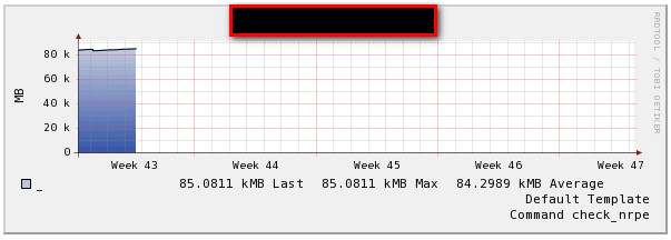

Hi All,
May I please ask for some assistance regarding on my Nagios not graphing. I've check all the files (rrd, xml) even my nagios.log are all in placed. Nagios checks are OK and no error, but it's not graphing :cry:

Is there any logs i need to check to verify some errors
The graph just stop generating even though i have an output in my checks
