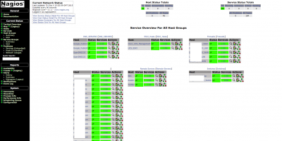

After update to 4.1.1 Nagios is very ugly
Post by Deadringers »
I don't know how else to put it other than ugly!
All I did was wget the new version, configure, make all and then install.?
Any ideas what I did wrong or how I can put it back to how it was?
Screenshot attached.

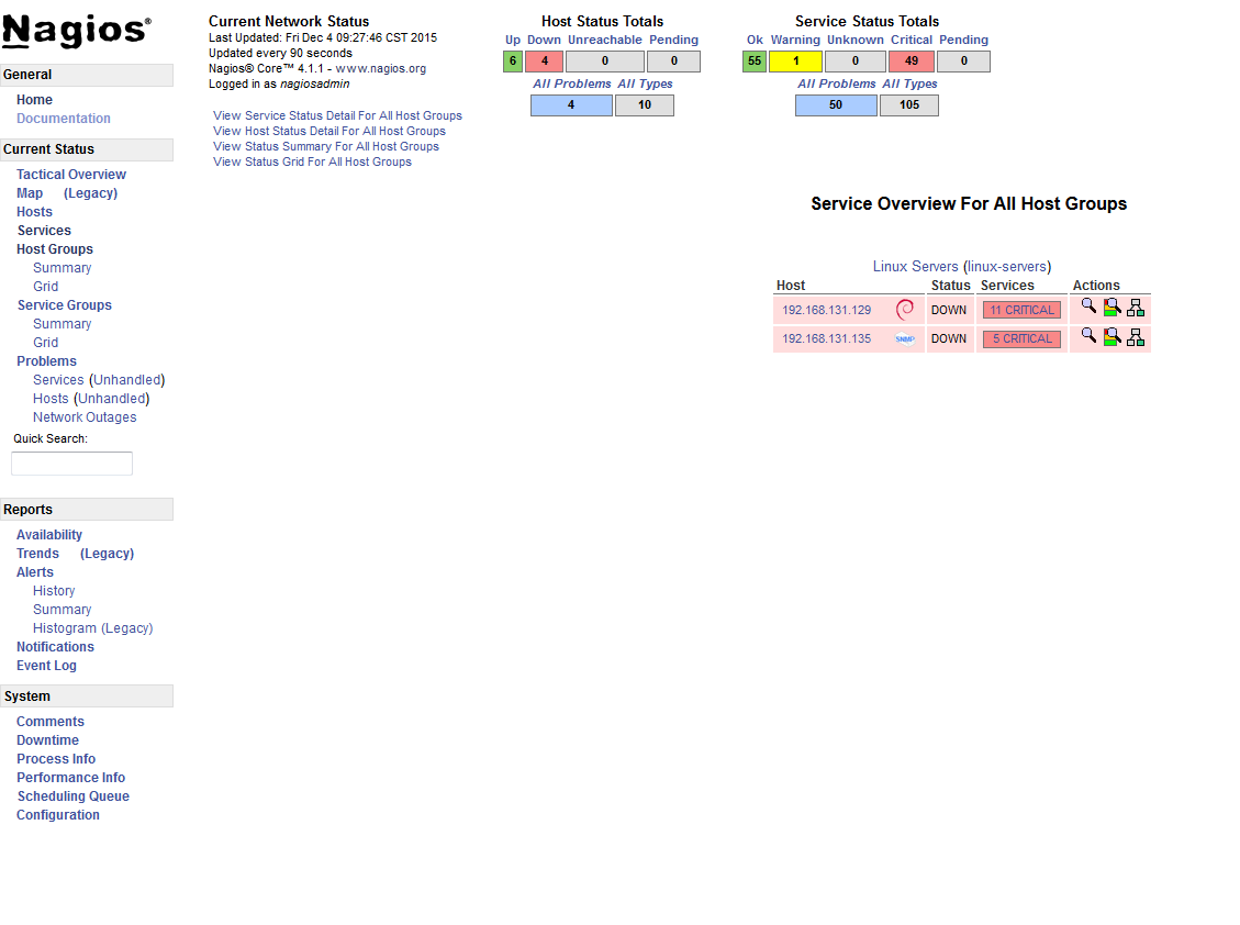

Are you running an interface on top of your Nagios or anything along side of it? Have any CSS changes been made to your install?
This doesn't look like a normal core install.
Attached is a screen shot of how a 4.1.1 looks for me.

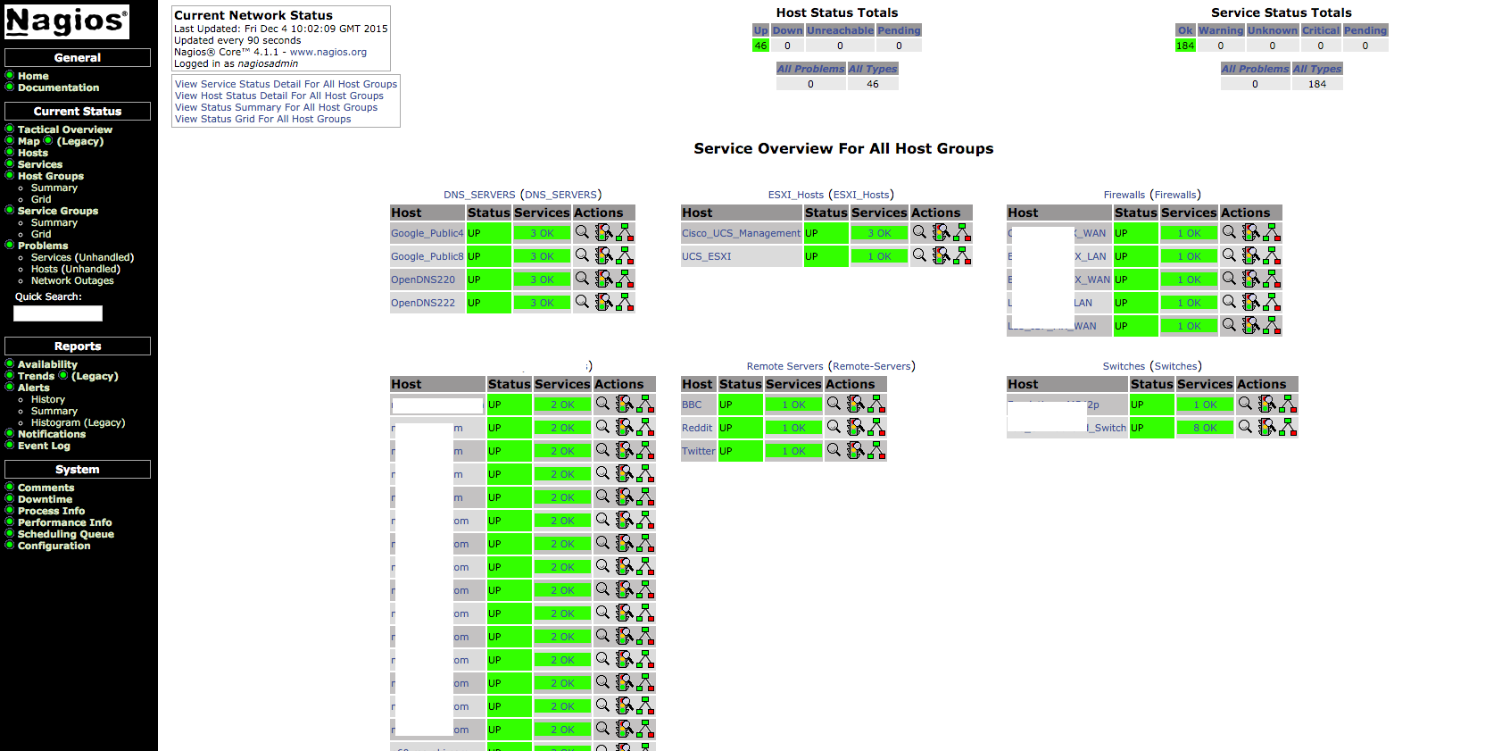

Re: After update to 4.1.1 Nagios is very ugly
Hey thanks for the response(s).
Yes my Nagios install looked like your screenshot before it turned into this.
I got it from the Nagios website.
Do you have a list of CSS files I can re-add or something like that?
I didn't make any changes, as stated I just configure/make/install as per usual when updating nagios.
