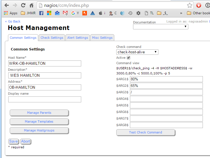

We maintain them in the CCM web interface at the url:
http://nagios/ccm/index.php
Screenshot attached.
Posts: 5126
Re: Nagios Core: Mass Update of Host .cfg files
Post by Box293 »
grantdoug wrote:Note that our Nagios hosts we have manually configured in the web interface are working perfectly.
Our question is specifically when we attempt to manually alter a host .cfg file, and upload it with SFTP, that we cannot see the change go into effect in the web interface.
grantdoug wrote:We maintain them in the CCM web interface at the url:
Because you are using Core Configuration Manager, all of the settings are stored in a database and then PUSHED down to the flat config files. CCM will have no idea that you've updated the flat config files and will overwrite them the next time you apply configuration.
