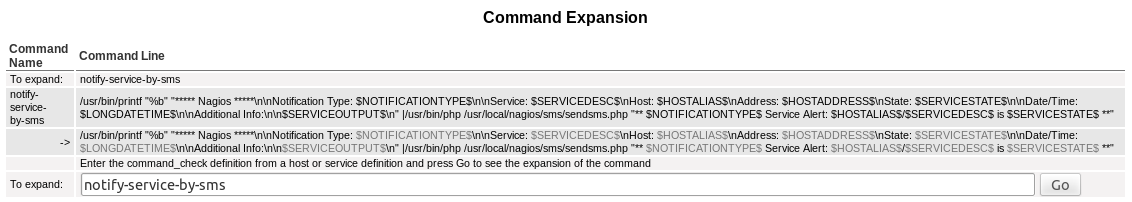

Getting below error in logs, Whenever i clicked Go button in command expansion, please find screenshot.
Moreover "usr" folder is not placed at "/usr/local/nagios/share/". Kindly help me to find out the issue ?
[root@monitor ~]# tail -f /var/log/httpd/error_log
[Tue Jan 26 04:28:11 2016] [error] [client 182.180.102.10] File does not exist: /usr/local/nagios/share/usr, referer: http://IP-Address/nagios/cgi-bin/status.cgi?host=all&limit=0
[Tue Jan 26 04:28:27 2016] [error] [client 182.180.102.10] File does not exist: /usr/local/nagios/share/usr, referer: http://IP-Address/nagios/cgi-bin/extinfo.cgi?type=2&host=Webs10&service=Current+Users
[Tue Jan 26 04:28:31 2016] [error] [client 182.180.102.10] File does not exist: /usr/local/nagios/share/usr, referer: http://IP-Address/nagios/cgi-bin/notifications.cgi?contact=all

Please post your apache configuration for us to take a look at.
Also, what version of Nagios are you running?

I have using nagios 4.1 version, please find httpd conf attachment.

I just installed core on a fresh machine, and noticed a different -
#DocumentRoot "/var/www/html"
DocumentRoot "/usr/local/nagios/share/"
Do you know why the existing DocumentRoot is commented out? Can you try uncommenting it, restart httpd / nagios and try again?

Even i have uncomment that line but it won't work again getting same error when press go button.

What OS are you running? Can you also post any other configuration files in your conf.d folder?
