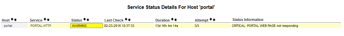

Also - can you post a screenshot of what you're seeing? It will help us to know what we're looking for in the configuration files you post.

- Service Alert
- service alert.png (11.03 KiB) Viewed 2689 times
Re: Service Monitoring Update
It looks as though you are hard-coding the portal address in your check command:
Try changing that to -h $HOSTADDRESS$ and it will pick up the host address of the machine, not a hard-coded value.
