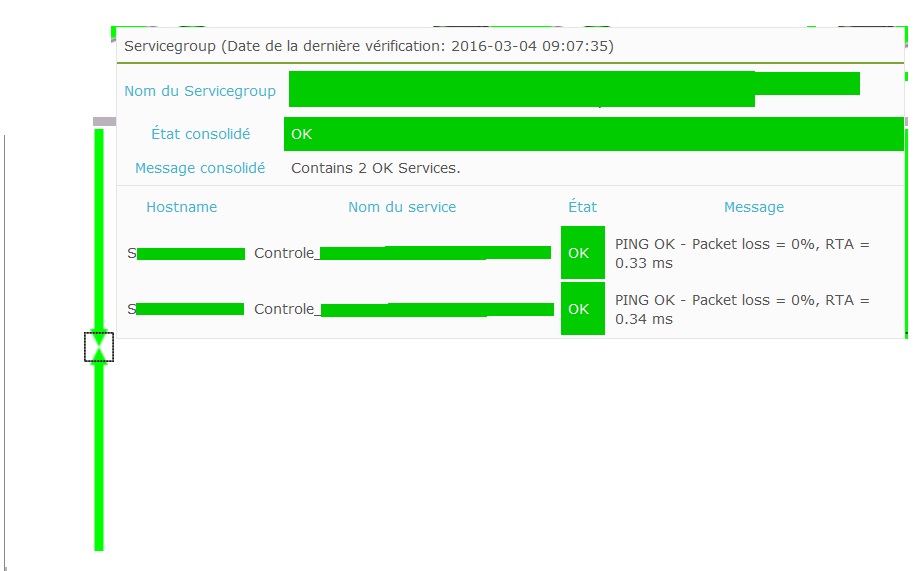

With Nagvis, when I slide the timekeeper of the mouse on an icon Service (Ping for example), I obtain the display by default from lines of the service Ping (Host Name - Name - State service - Output)
I wanted to know if I could have (not the service line), but directly the graph pnp4nagios of the traffic ping) without clicking.
I thank you for it in advance.

In the passage of the mouse, I obtain the image: Before.jpg.
I would want not the services, but a graph ( After.jpg).

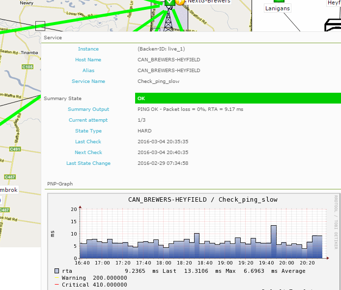

Re: Nagvis: display of a service in graphic
Post by nozlaf »
if you set the line to depict a single host or service you will get a graph however you have selected a servicegroup so you are getting the summary for the group

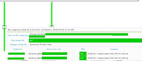

By default, on Nagvis, when we move the mouse on an icon (without clicking), we obtain the status of every dedicated service (see photo 1).

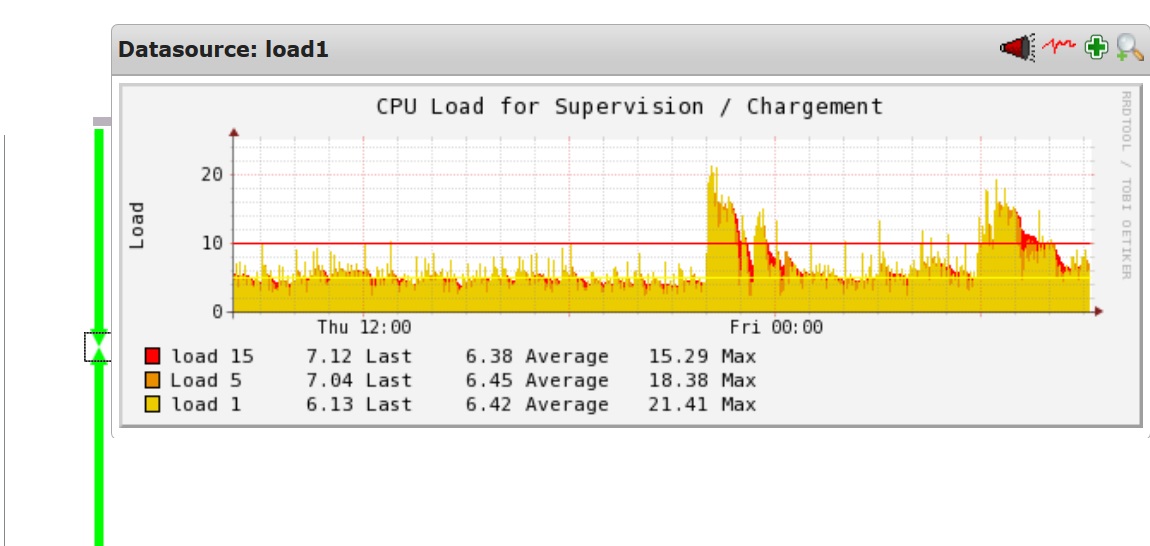

What I wish, it is not the status of the services (ping for example), but a graph ( pnp4nagios ) (see photo 2)

Behavior by default (in the passage of the mouse, without clicking)
The result (in the passage of the mouse, without clicking).<br />A graph instead of the standard display.
Post by nozlaf »
so to achieve this the hover_template on my system needs to be set to "default-pnp"
this is vary from system to system depending on how you have configured it etc..
because my nagvis is very old and has been upgraded many times I don't know if that's what the template is called by default or what it contains
but this is what I have in my template file
this is the contents of my /usr/local/nagvis/share/userfiles/templates/default-pnp.hover.html file

this is what you want i think
