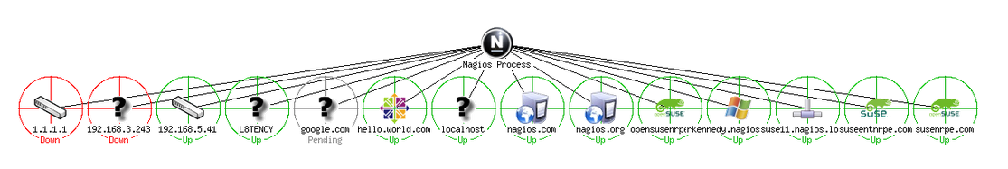

Re: StatusMap Nagios 4x
The documentation here (https://assets.nagios.com/downloads/nag ... igcgi.html) outlines the changes that can be made to the Statusmap.
For instance, I modified my /usr/local/nagios/etc/cgi.cfg and added -
default_statusmap_layout=1
This will grant a look less like a map similar to this -
Is that what you're looking for? If not, could you illustrate to further show us?
It should be going red as you can see in my screenshot above. Can you post a screenshot of what you're seeing now, and any changes you've made to the cgi.cfg so far?
I'll try to replicate this on my end with that information.

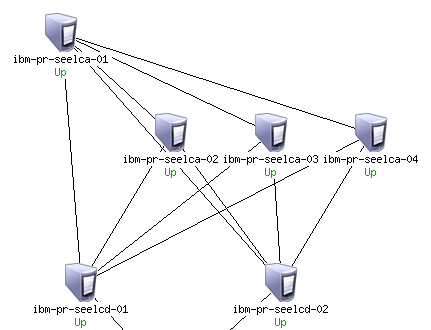

delboy1966
Posts: 98
Joined: Thu Oct 22, 2015 5:26 am
Post by delboy1966 »
This is what I have now that I supplied 2d_coords to all the hosts in the hostgroup
Which looks a bit better now.
However I understand that statusmap is at the host level and as all hosts are up they all show green.
But I have a couple of services on 2 of the hosts in the map that are either critical or warning, I would like the host in the map to show this visually without having to hover over the host and see it from the popup.
So the most severe status will be indicated on the host in the map, if a host has 1 critical and 1 warning service, the host should show red, but if there is just a warning then it should show yellow.
I have seen some patches for statusmap.c for Nagios v3x that make this possible, but thus far I haven't seen any patches or solutions for Nagios v4x.
Tony
