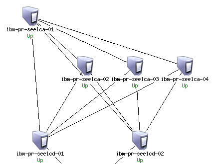

Posted: Mon Mar 14, 2016 2:03 am
by delboy1966
This is what I have now that I supplied 2d_coords to all the hosts in the hostgroup
Which looks a bit better now.
However I understand that statusmap is at the host level and as all hosts are up they all show green.
But I have a couple of services on 2 of the hosts in the map that are either critical or warning, I would like the host in the map to show this visually without having to hover over the host and see it from the popup.
So the most severe status will be indicated on the host in the map, if a host has 1 critical and 1 warning service, the host should show red, but if there is just a warning then it should show yellow.
I have seen some patches for statusmap.c for Nagios v3x that make this possible, but thus far I haven't seen any patches or solutions for Nagios v4x.
Tony
