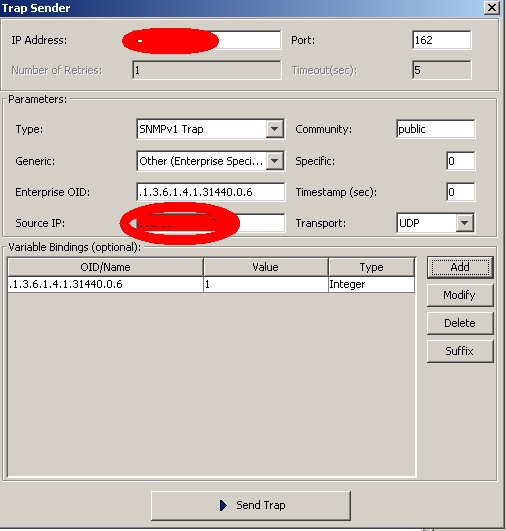

One more questions i have to ask
I just want to test some snmptt entries against ...
So I use the ireasoninig browser for it but i'm not sure in which way i have to set the values in the interface for an proper test.
Here is an picture from it:
Trap-Test
Trap-Test
Is this correct or does it not fit the Trap definition which i've described before.
regards skyerjoe

Your screenshot shows SNMPv1 traps.
Try sending v2c traps, it's a little less complicated.

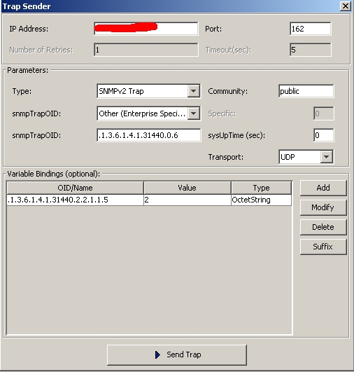

Hello again
I tried to reproduce an trap from my ow-server but i cannot reach the finish line atm I'm struggle with the definition and the trap ...
I use the advise to explore the logs from snmptt:
Here is my log which our ow server produce:
Wed Apr  6 14:24:53 2016: Unknown trap (.1.3.6.1.4.1.31440.0.6) received from xxx.16.9.117 at:
Value 0: xxx.16.9.117
Value 1: xxx.16.9.117
Value 2: 458:20:54:30.15
Value 3: .1.3.6.1.4.1.31440.0.6
Value 4: xxx.16.9.117
Value 5: public
Value 6: .1.3.6.1.4.1.31440
Value 7:
Value 8:
Value 9:
Value 10:
Ent Value 0: .1.3.6.1.4.1.31440.2.2.1.1.5=2
Here is my trap which should reproduced the original one:
Wed Apr  6 16:22:42 2016: Unknown trap (.1.3.6.1.4.1.31440.0.6) received from test-pc.local.1 at:
Value 0: test-pc.local.1
Value 1: xxx.16.9.138
Value 2: 0:0:00:00.00
Value 4: xxx.16.9.138
Value 5:
Value 6:
Value 7:
Value 8:
Value 9:
Value 10:
And this is the Trap Definition which i want to trigger
EVENT wateralertOWSERVER .1.3.6.1.4.1.31440.0.6 "Status Events" Testing
FORMAT Water Status $+1
EXEC /usr/local/nagios/libexec/submit_check_result ow-server  "Water Alert level 2" 2 "Water status is critical"
#MATCH $+1:(31440.2.2.1.1.5:2)
MATCH $x:.1.3.6.1.4.1.31440.2.2.1.1.5:2
SDESC
ow-server alert
EDESC
I'm not sure which i have to reproduce it
May trap sender looks like this:
regards skyerjoe
Nagios Core 3.5.1
Checkmk 1.2.4p5
