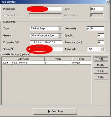

I just want to test some snmptt entries against ...
So I use the ireasoninig browser for it but i'm not sure in which way i have to set the values in the interface for an proper test.
Here is an picture from it:
- Trap-Test
Is this correct or does it not fit the Trap definition which i've described before.
regards skyerjoe

Your screenshot shows SNMPv1 traps.
Try sending v2c traps, it's a little less complicated.
