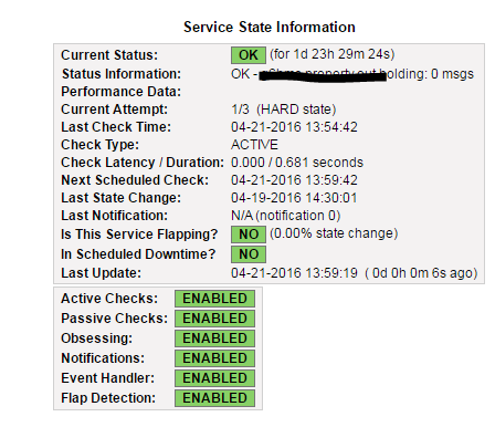

i have been trying to moniter it through graph
i have attached image for more specification
This service doesnot show service perfdata

Re: how to create service perfdata

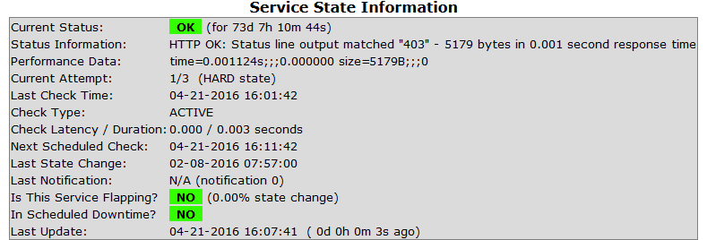

As I mentioned, your service is NOT returning performance data. If check_ping is working without issues, then clearly performance data is enabled on your system. If the service was returning performance data, you'd see something similar to this, with the 'Performance Data:' part not empty -
