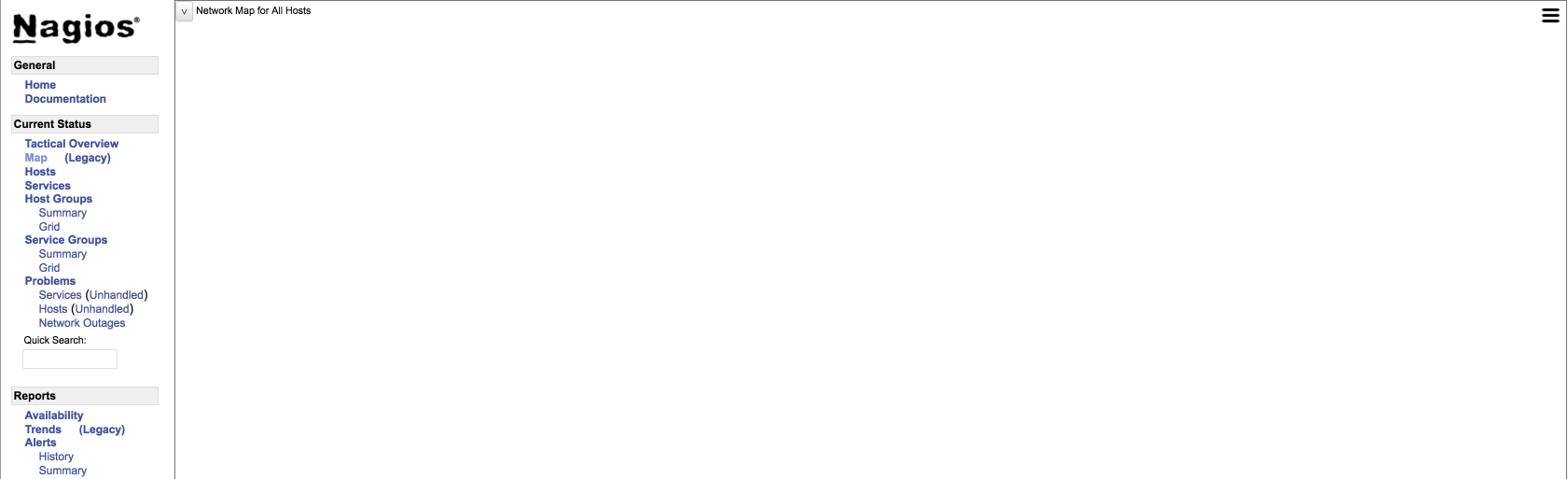

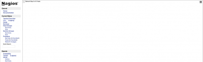

My problem : I've read that the statusmap on nagios is generated automatically, but when I open "Map" on the interface web, I've nothing, only this :
Network Map for All Hosts
Last Updated: none
Nagios® Core™ 4.1.1 - www.nagios.org
Updated every 10 seconds
Logged in as nagiosadmin
View Status Detail For This Host
View Status Detail For All Hosts
View Status Overview For All Hosts
And next to "Map", there is (Legacy). When I click, I have the following message :

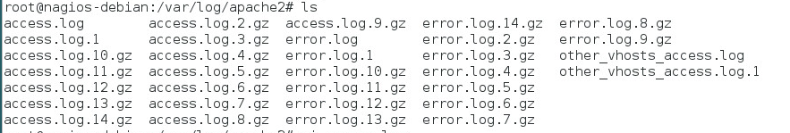

Can you post your logs for us to take a look at? (if you can't find one of them, look around, I might be slightly off depending how your logs are setup.)
/var/log/apache2/error_log
/var/log/apache2/access_log

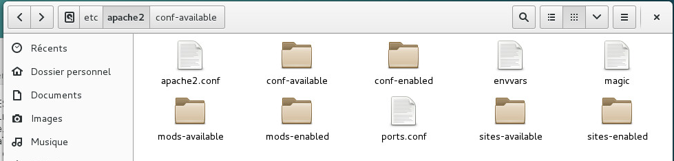

Also, we'll need to see /etc/apache2/conf/httpd.conf and your entire /etc/apache2/conf.d/ directory (feel free to zip it up).
cocoyanouck
Posts: 96
Joined: Fri Apr 08, 2016 3:17 am
Re: Map is blank - Legacy is not found
Post by cocoyanouck »
For sure, but for the log, there are many files, do you need all theses files? Is this normal...?
About apache2, I've not httpd.conf but apaches2,conf, I suppose it's the same thing.
apache2.zip
(68.72 KiB) Downloaded 163 times

Second message to upload apache logs and errors.
apache log & error.7z
(143.89 KiB) Downloaded 182 times

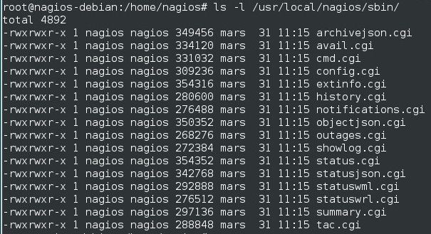

What is the output of these commands:
ls -ld /usr/local/nagios/sbin
ls -l /usr/local/nagios/sbin
cocoyanouck
Posts: 96
Here it is.

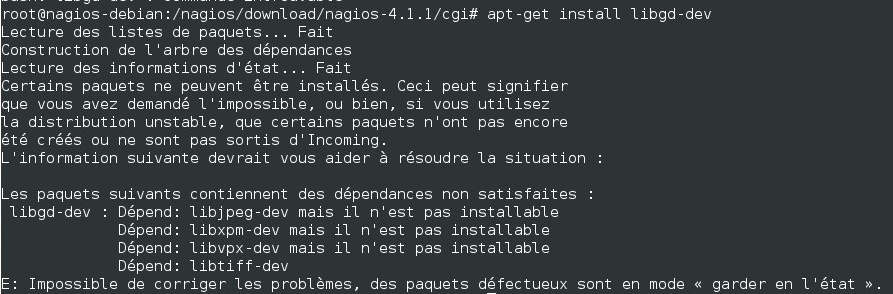

Maybe It could help you, or maybe this is another problem/distinct, but when I check the directory where I have downloaded nagios 4.1.1 for the installation, if i test "ls" I only have statusmap.c but not .cgi.
And I've read on the net that this is a problem during installation and compilation of nagios with outbuildings of libgd witch prevent the files creation of statusmap.cgi for instance.
Like I said, there is no libgd2 installed, but libgd3 on Debian 8 Jessie. And I couldn't install libgd2-xpm and libgd2-xpm-dev but only libgd3.
And if I want to test "libgd-dev I've the following error :
cocoyanouck
Posts: 96
Ok, I've done a few things : I've modify /etc/apt/source.list which used DVD instead of official sources...
Then, after apt-update and apt-upgrade, I've managed to install libgd2-xpm and libgd-dev.
Finally, I've done this :
./configure –with-gd-lib=/usr/local/lib/
Then "make cgis"and verify if there was statusmap.cgi with this :
cd cgi/
ls *.cgi
And a copy in the directory of nagios :
cp *.cgi /usr/local/nagios/sbin/
I've restart Nagios service, and in the web interface, when I click on "Legacy", I've a map !!!!!!! (see the upload file).
So good.
But when I click on 'Map", I still have nothing. Maybe can I use only the part "Legacy" to use a custom image and indicate coordinates on each host ?

Good job on the statusmap.cgi one, that's what I was thinking.

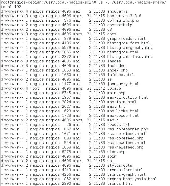

Let's check for map.html and the permissions that are set:
ls -ld /usr/local/nagios/share/
ls -l /usr/local/nagios/share/
What does the page show when you click on Map, any errors or anything?
The map is missing but there is no message.
