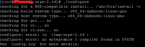

Hi Rkennedy,
I get this Error while installing the NRPE.
anyway out please ?

Re: Monitor Linux Server which doesnt have Internet access.,
You'll need a compiler in order to accomplish this, what OS are you running on the machine?
For Ubuntu / Debian -
apt-get install build-essential
For CentOS/RHEL -
yum install gcc glibc glibc-common gd gd-devel -y

Thanks Rkennedy i have Decided to give Interne to the Machine for a short time because i have already tried with Installing Locally the GCC complie and so on, there is so many Depandancies pacakges , i have to also install and to install this Packages Locally on the machine which doesnt have Internet is not easy task.
