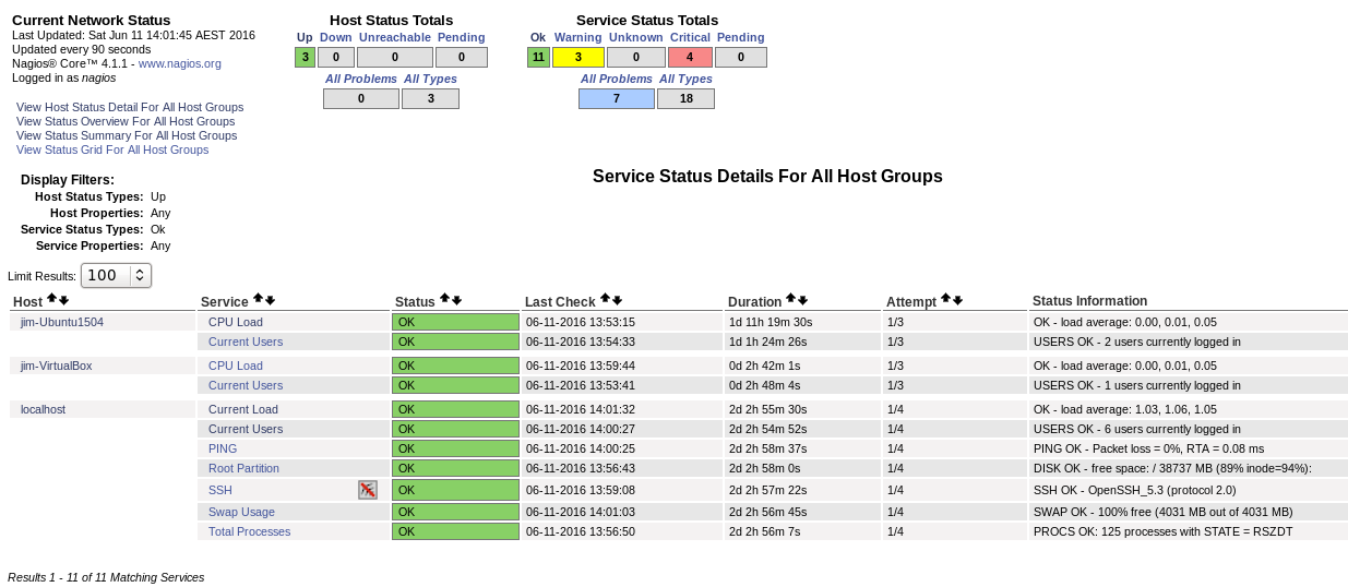

Hi All,
I need some help with Nagios monitoring.
I installed on server and agents but when I go to main screen I see only two services being monitored and what is says is that two services in "Critical"
I have attached screenshots for the same but what is says is the below two services monitored on agents ?? I thought they should be eight ?
Current Users
CPU Load

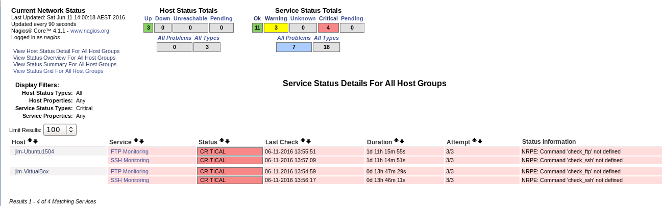

The following services are critical with command not found error:
SH Monitoring -- NRPE: Command 'check_ssh' not defined
FTP Monitoring-- NRPE: Command 'check_ftp' not defined
Any help would be greatly appreciated.
Thanks in advance.
Critical services reported by nagios

If I can do ssh from Nagios server to agents why does the UI say NRPE: Command 'check_ssh' not defined ??

in your nagios configuration you have not defined the check_ssh command and check_ftp command
maybe a little confusing but having the binaries in the libexec folder doesn't actually "install" the plugin , you need to define the command somewhere like this
                command_name                          check_ftp
                command_line                          $USER1$/check_ftp -H $HOSTADDRESS$ $ARG1$
                command_name                          check_ssh
                command_line                          $USER1$/check_ssh $ARG1$ $HOSTADDRESS$
so i have a check_commands.cfg file that holds all of my commnands

Since you're using NRPE, and checking through an agent what @nozlaf mentioned does not apply. What you need to do is define commands in NRPE, so that when check_nrpe executes from Nagios, it then knows how to pass check_ftp or check_ssh to the client machine. Your example here isn't using NRPE, but rather local files. So you would need to decide what you're ultimately trying to do.
[root@agent2 libexec]# ./check_ssh puppet
SSH OK - OpenSSH_7.2p2 Ubuntu-4ubuntu1 (protocol 2.0) | time=0.025016s;;;0.000000;10.000000
[root@agent2 libexec]# ./check_ssh Xubuntu
SSH OK - OpenSSH_7.2p2 Ubuntu-4ubuntu1 (protocol 2.0) | time=0.025308s;;;0.000000;10.000000
Changing these around would mean to change your check_command to check_ssh, which @nozlaf was checking.
        host_name               jim-VirtualBox
        service_description     SSH Monitoring
        check_command           check_nrpe!check_ssh
        service_description     FTP Monitoring
        check_command           check_nrpe!check_ftp
The nrpe.cfg is where you would add any plugins that you want to monitor, and also define commands that can be used on that client machine. What you've pasted, for example, are 5 different commands that can be executed using NRPE.
command[check_hda1]=/usr/local/nagios/libexec/check_disk -w 20% -c 10% -p /dev/hda1
At this point, if your check_ssh and check_ftp can be executed using nagios, then change your check_command to check_ssh and not check_nrpe!check_ssh. If you need to execute these plugins using NRPE, create a definition and then restart NRPE (possibly xinetd depending how you installed) for check_ssh.
