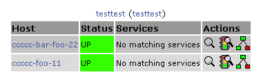

I believe the , is the delimiter that Nagios will use when registering the service. You should still be able to accomplish this by creating a regex match for each difference, and separating it by using commas. For example -
define hostgroup {
hostgroup_name testtest
members ^(aaaaa|bbbbb|ccccc|ddddd|eeeee|fffff)\-foo\-[0-9]{2}$,^(aaaaa|bbbbb|ccccc|ddddd|eeeee|fffff)\-bar\-foo\-[0-9]{2}$
define host {
        use                             linux-server
        host_name                       ccccc-foo-11
        alias                           ccc Alias Monitoring
        address                         localhost
        max_check_attempts              5
        notification_interval           30
define host {
        use                             linux-server
        host_name                       ccccc-bar-foo-22
        address                         localhost
