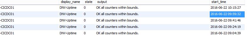

I have noticed that despite the defined service template configuration being as follow:
max_check_attempts              5                       ; Re-check the service up to 5 times in order to determine its final$
normal_check_interval            5                       ; Check the service every 5 minutes under normal conditions
retry_check_interval               1
The intervals of servicechecks are longer than expected. It's always beyond 5 minutes (see attached image):
Can anyone give me any insight on this please?
Thank you in advance

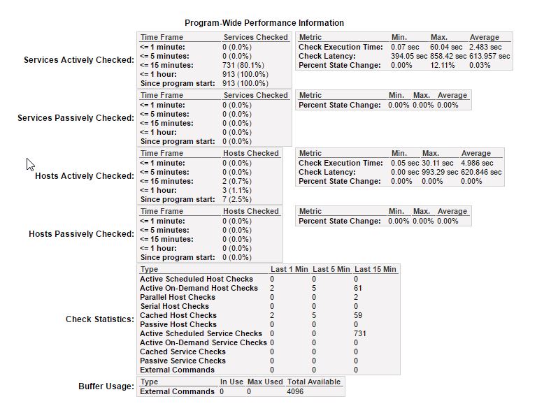

All looks good there, could you also attach a screenshot of your Performance Info page?

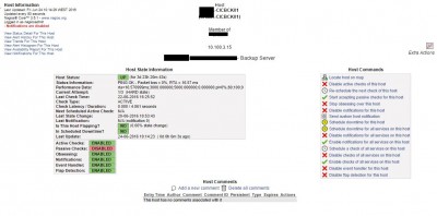

Also - could you attach a screenshot of one of the service detail pages? I'd like to see what the 'last check time' and 'next scheduled check' times are lining up to.

Hello!
The print screens are attached to this message.
Thank you :)

Re: Service checks delay
The screen captures are showing that the scheduler isn't running the checks quick enough and there are some settings you can change in the nagios.cfg file to fix that.
