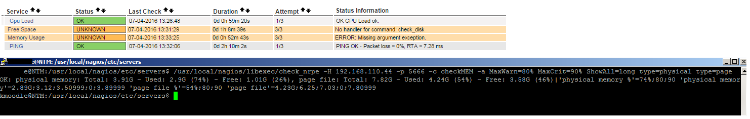

For the memory check you've defined it all in the check command check_Mem, so you need to update your service definition to use this command:
        host_name               NB-Homer
        service_description     Memory Usage
        check_command           check_Mem
For the disk space, there is no "check_disk" command in NSClient++. Have a look at these command examples:
http://sites.box293.com/nagios/guides/c ... disk-usage
Does this help?

Hi, I uninstalled NSCP-0.4.1.73-x64 client and install NSClient++-0.3.8-x64. Then I followed the instructions from https://support.nagios.com/forum/viewto ... =7&t=24911. It works, but result of Memory Usage is: "(No output on stdout) stderr: execvp(check_nrpe, ...) failed. errno is 2: No such file or directory".
****************commands.cfg ***************
# check_nrpe_memory
command_name checkMEM
command_line check_nrpe -H $HOSTADDRESS$ -p 5666 -c checkMEM -a MaxWarn=$ARG1$ MaxCrit=$ARG2$ ShowAll type=physical
and
*************Homer.cfg**************
host_name Homer
check_command checkMEM!90!95
and

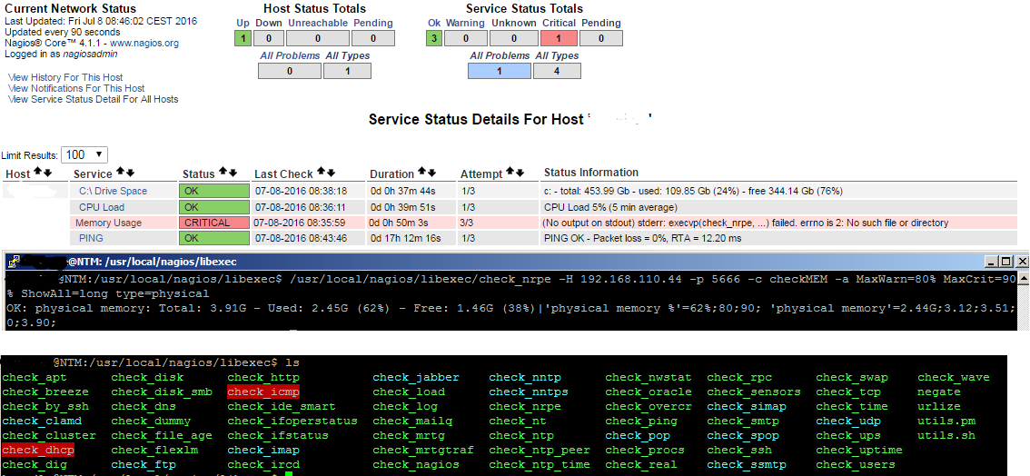

The issue is how your check_nrpe_memory command is defined -
You need to add the $USER1$ macro before calling the command, otherwise you're just calling 'check_nrpe'. Change it to this -
command_line $USER1$/check_nrpe -H $HOSTADDRESS$ -p 5666 -c checkMEM -a MaxWarn=$ARG1$ MaxCrit=$ARG2$ ShowAll type=physical
Then restart nagios, and try again.

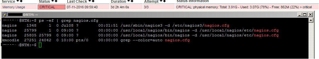

But I have question. Why is status CRITICAL when my Homer.cfg file contains command "!90!95":
host_name Homer
check_command CheckMEM!90!95
Where can I change command values?

Did you restart nagios after updating the config and force an immediate check of the service?
blaha
Posts: 19
Joined: Fri Jul 01, 2016 6:01 am
Re: No handler for command: check_nrpe_mem
Post by blaha »
Hi, I restarted nagios but I do not know how to "force an immediate check of the service".
Posts: 5126
Post by Box293 »
Click on the service so you are on the details of the service.
Under "Service Commands" click "Re-schedule the next check of this service"
Click Commit
Click Done

If your service is still incorrect, what is the output of this command:
ps -ef | grep nagios.cfg

Hi, every same problem, more information in picture.
