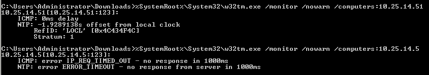

As per the link you provided, we have done all the required changes in Nagios server and remote host as well.
When we tried to test the check, locally in remote host we are facing the below attached error.
Can you please help me to sort out this.
Regards
B Uday Kumar
- Error we are facing while executing script locally in remote machine.
- Error.PNG (4.17 KiB) Viewed 6585 times

I tested this and I found I got the same error when I provided an invalid IP address. When the IP address I provided was able to be contacted it worked OK. Check your firewall to see if the NTP ports are open.
From looking at the script, here is the command the script executes:
You can see the second attempt is to an unreachable address.
