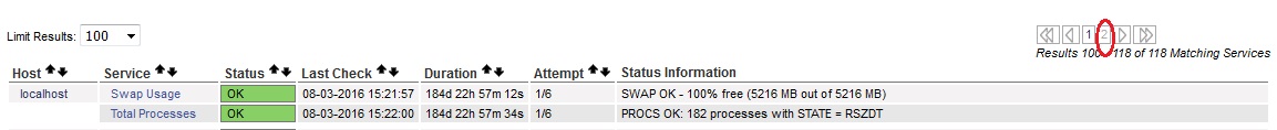

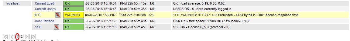

i have a problem i have added some host to my nagios monitoring but just have a problem i have take a pic from my problem and attached for example my localhost some sensors show on page 1 and one of them show on page 2
how can put all sensors for my localhost on one page
best regards
Babak

Sorry if stating the obvious, but have you tried increasing the value in the "Limit Results" drop down?

so thanks
if i change that it won\t be fix for all time and every time and maybe that is temporary how can fix it for all times?

but i think you did not understand my question correctly 2 notice:
1 - i don't want show all hosts on one page
2 - for example if i have 30 host i want nagios show them complete means if my localhost put on page 1 show all localhost sensors on page 1 not show 3 of localhost sensors on page 1 and 2of sensors show on page 2
how can solve this problem ?
