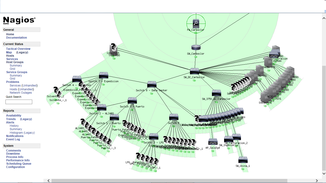

Hi guys,
can you help me with this ??
On my nagios core i see a worng display with all icon overlap.
I attach the file.
Regards.

Re: Nagios Core - Map Legacy - Wrong Display
I believe this is expected due to the sheer amount of services you have. You should be able to change your /usr/local/nagios/etc/cgi.cfg file, specifically the default_statusmap_layout= variable to a different number.
See this link for the options on what you can change it to - https://assets.nagios.com/downloads/nag ... map_layout

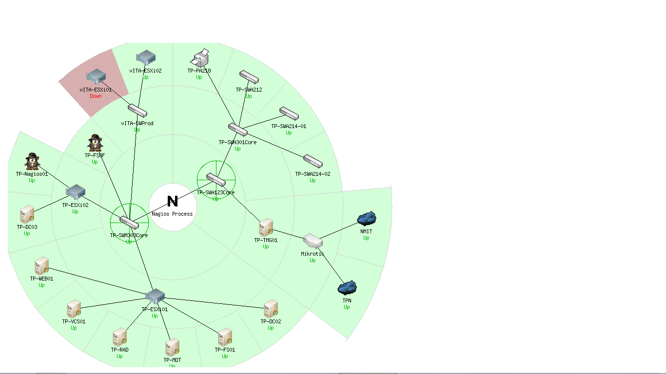

thanks for the information but i want to see like the attachment.
how i can do that ??
This is described on the page @rkennedy linked:
The style you are looking for should be named "Circular (Marked Up)". Try default_statusmap_layout=5
As pointed out by @rkennedy, the map is going to be a bit squished due to the sheer number of parents/children in your setup.
