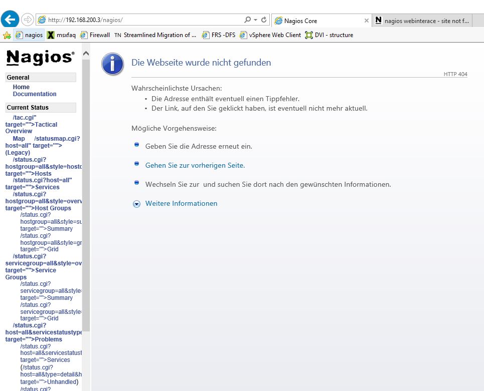

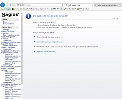

Hey,
i installed nagios 4.1.1 on a vmserver ubuntu 16 without without any Errors.
i followed this guide http://www.ubuntugeek.com/install-nagio ... erver.html and everything was fine.
but when i try to check out the webinterface http://localhost/nagios i`m able to log on but then i get the site not found error - http 404
i restarted nagios and apache2 Service and both are up and running.
Any Ideas?

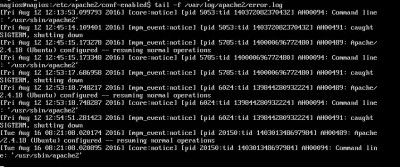

Please run the following from the command line. While it is running reproduce the 404 error and after you see it, copy the output and post it here.
tail -f /var/log/apache2/error.log
Also, referencing the install guide you used, did you "Run the following command instead of make install-webconf" (see the section "Compile and install Nagios Using the following commands")
sudo /usr/bin/install -c -m 644 sample-config/httpd.conf /etc/apache2/sites-enabled/nagios.conf

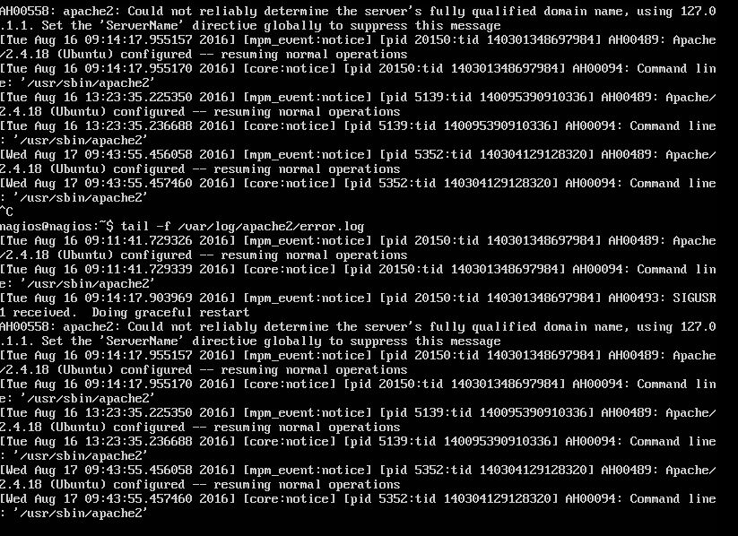

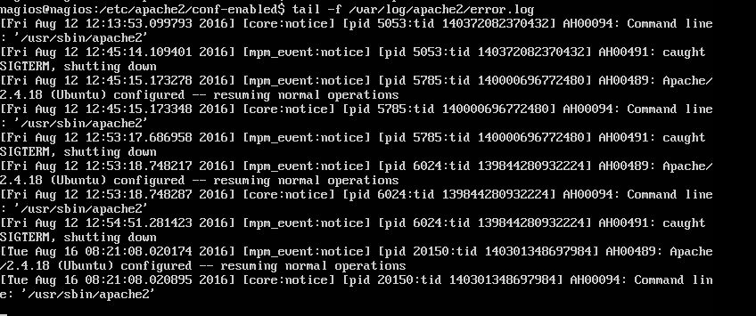

I ran the command and uploaded the error.log.
After i got the error message´:
/usr/bin/install -c -m 644 sample-config/httpd.conf /etc/httpd/conf.d/nagios.conf
/usr/bin/install: cannot create regular file ‘/etc/httpd/conf.d/nagios.conf': No such file or directory
Makefile:296: recipe for target ‘install-webconf' failed
make: *** [install-webconf] Error 1
thats why i used : sudo /usr/bin/install -c -m 644 sample-config/httpd.conf /etc/apache2/sites-enabled/nagios.conf without any error Messages.
thanks

Can you refresh the page that is erroring out a few times, and then post your entire error_log? It doesn't look like anything in that screenshot is applicable as to what's going on with apache not being able to load the Core file.

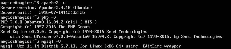

In addition to this, can you run the following commands and show the output?
apache2 -v
php -v
mysql -V
systemctl is-enabled nagios
cat /etc/init.d/nagios
ps -ef | grep 'nagios\|apache2'Be sure to check out our Knowledgebase for helpful articles and solutions!
